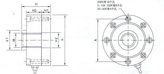

Èý¡¢ÍâÐγߴ磺
Á¿³Ì t
³ß´ç (mm)
A
φ
φ 1
φ 2
H
H1
H2
M
0.5£­7.5
88.9
104.7
32.0
18.0
53.8
19.0
31.8
M16*1.5
10-25
101.6
120.7
38.9
34.0
77.8
24.0
41.1
M32*1.5
116.8
140.0
50.4
42.0
86.2
29.0
50.8
M40*1.5
60-100
162.0
200.0
76.0
64.0
125.0
42.0
70.0
M60*2
