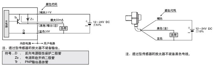

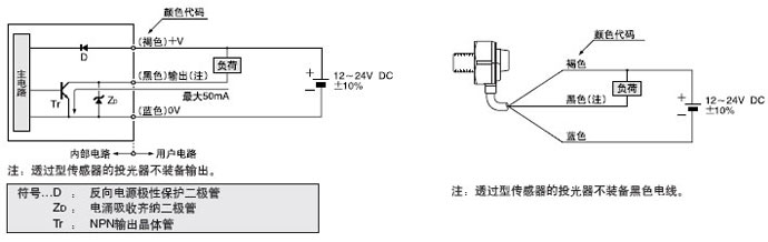

I/Oµç·ͼºÍÏß·ͼ
NPNÊä³öÐÍ
I/Oµç·ͼ
Ïß·ͼ
PNPÊä³öÐÍ
I/Oµç·ͼ
Ïß·ͼ
