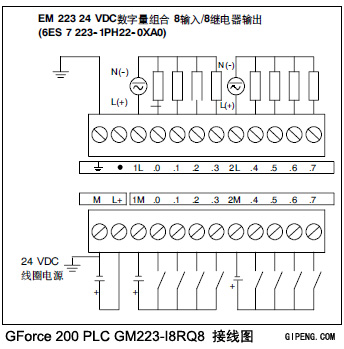

       GForce-200 PLC EM223R Êý×ÖÁ¿ÊäÈëÄ£¿é£¬8µã ÊäÈë 24VDC 8µã Êä³ö ¼ÌµçÆ÷ GM223R-I8RQ8
    ÐÔÄܲÎÊý
     ³£¹æÌØÐÔ
    ³ß´ç(¿í¡Á¸ß¡ÁÉî) 71.2¡Á80¡Á62mm
    ¹¦ºÄ 3W
     Êý×ÖÁ¿ÊäÈëÌØÐÔ
    Êý×ÖÁ¿ÊäÈëµãÊý 8
    ÊäÈëÀàÐÍ Â©ÐÍ/Ô´ÐÍ (IEC ÀàÐÍ1/©ÐÍ)
    ¶î¶¨µçѹ 24V DC
    ×î´ó³ÖÐøÔÊÐíµçѹ 30V DC
    Âß¼­1ÐźŠ( ×îС)
    Âß¼­0ÐźŠ( ×î´ó)
    18 VDC£¬2.5mA
    5 VDC£¬1mA
    ¸ôÀë(ÏÖ³¡ÓëÂß¼­)
    ¹âµç¸ôÀë
    ¸ôÀë×é
    ÓÐ
    500V AC£¬1·ÖÖÓ
    ¼û½ÓÏßͼ
    ͬʱ½ÓͨµÄÊäÈë 8
    ×î´óµçÀ³¤¶È
    ÆÁ±Î
    ·ÇÆÁ±Î
    500Ã×(±ê×¼ÊäÈë)
    50Ã×(¸ßËÙ¼ÆÊýÆ÷ÊäÈë)
    300Ã×(±ê×¼ÊäÈë)
     Êý×ÖÁ¿Êä³öÌØÐÔ
    Êý×ÖÁ¿Êä³öµãÊý 8
    Êä³öÀàÐÍ ¼ÌµçÆ÷£¬¸É´¥µã
    ÿµã¶î¶¨µçÁ÷(×î´ó)
    ÀËÓ¿µçÁ÷(×î´ó)
    2A
    5A£¬´¥µã¹Ø±Õ
    µÆ¸ºÔØ(×î´ó) 5 WDC/200WAC
    ½Óͨµç×è(½Óµã) 0.2Å·Ä·
    ͬʱ½ÓͨµÄÊä³ö 8
    Á½¸öÊä³ö²¢Áª ÊÇ£¬½öÊä³öͬ×éʱ
    ×î´óµçÀ³¤¶È
        ÆÁ±Î
        ·ÇÆÁ±Î
    500Ã×(±ê×¼Êä³ö)
    150Ã×(±ê×¼Êä³ö)
    ½ÓÏßͼ
