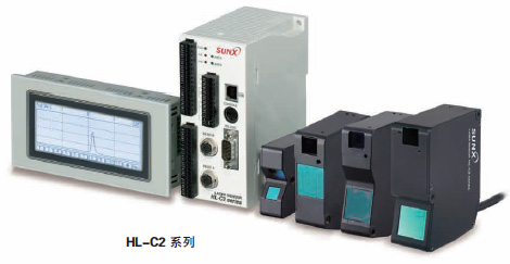

panasonicÈÕ±¾ËÉÏÂÎ»ÒÆ´«¸ÐÆ÷LM10-250,ANR1226,LM10-130,ANR1215
Äý½áÁËм¼ÊõµÄ³¬¸ßËÙ¡¢¸ß¾«¶È¼¤¹âÎ»ÒÆ´«¸ÐÆ÷ÉÏÐÂÔö350mm³¤¾àÀë¼ì²âÍ·£¬Âú×ãÓû§µÄÒ»ÇÐÐèÇó¡£

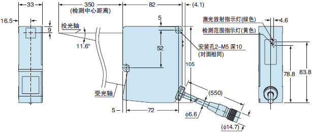

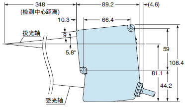

³ß´ç(µ¥Î»mm)
ÉèÖÃģʽ£ºÀ©É¢·´Éä
À©É¢·´Éä
ÉèÖÃģʽ£ºÕý·´Éä
Õý·´Éä
