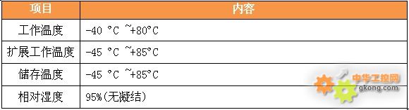

    CM3180P/CM3180EP²ÉÓõ¥Ð¾Æ¬SOC·½°¸Éè¼Æ£¬Õû»ú¹¦ºÄÊÇÒµÄÚÆù½ñ×îµÍµÄÒ»¿î²úÆ·¡£²úÆ·¿ÉÒÔͨ¹ýÓ²¼þ¹Ü½Å¹Ø±ÕϵͳµçÔ´¹¦ºÄ<0.1mA,¿ÉÒÔʵÏÖϵͳÐÝÃß¹¦ºÄ<1mA£¬²úÆ·´ý»ú¹¦ºÄ<15mA,Êý¾Ý´«Ê书ºÄ<90mA£¨¹¦ºÄ¸ú»ùÕ¾ÐźÅÇ¿¶ÈÓйأ©¡£Í¬Ê±CM3180P/EPÒ²Éè¼Æ³É¿íÎµĻ·¾³£¬²úÆ·¿ÉÒÔÊÊÓ¦¼«Æä¿Á¿ÌµÄ¸ßκ͵Íλ·¾³£¨-40 ºC¡«80 ºC£©.

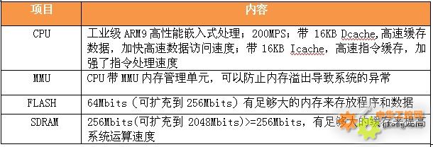

    ¸Ã²úÆ·²ÉÓÃARM9¹¤Òµ¼¶¸ßÐÔÄÜǶÈëʽ´¦ÀíÆ÷£¬ÒÔʵʱ²Ù×÷ϵͳΪÈí¼þÖ§³Åƽ̨,³¬´óÄÚ´æ,ÄÚǶ×ÔÖ÷֪ʶ²úȨµÄTCP/IPЭÒéÕ»£»Í¬Ê±Ìṩ´®¿ÚRS232¡¢RS485½Ó¿Ú¡¢RS422½Ó¿Ú¡¢TTL½Ó¿Ú»òÕßUSB½Ó¿Ú£¬É豸¿ÉÒÔÖ±½Ó¿Í»§µÄ´®¿Ú/USBÉ豸ÏàÁ¬£»É豸֧³ÖË«Êý¾ÝÖÐÐı¸·Ý£¬ÒÔ¼°¶àÊý¾ÝÖÐÐÄͬ²½½ÓÊÕÊý¾ÝµÈ¹¦ÄÜ£»É豸ÌṩÔÚÏßά³Ö¼¼Êõ£¬±£³ÖÊý¾ÝÖÕ¶ËÓÀ¾ÃÔÚÏߣ¬±£´æÊý¾ÝÁ´Â·ÈκÎʱºò³©Í¨£¬ÊµÏÖ¸ßËÙ¡¢Îȶ¨¡¢¿É¿¿µÄTCP/UDP͸Ã÷Êý¾Ý´«Ê书ÄÜ¡£Õý¶Ô¶ÔÍøÂçÁ÷Á¿ºÍ²úÆ·¹¦ºÄ±È½ÏÃô¸ÐµÄ¿Í»§£¬±¾²úÆ·Ö§³ÖÓïÒô¡¢¶ÌÐÅ¡¢Êý¾Ý´¥·¢ÉÏÏßÒÔ¼°³¬Ê±×Ô¶¯¶ÏÏߵŦÄÜ£¬½µµÍÁ÷Á¿½µµÍ²úÆ·¹¦ºÄ£¬ÊµÏֵ͹¦ºÄ¹¦ÄÜ¡£
    ¸Ã²úÆ·ÓµÓÐARM9¹¤Òµ¼¶´¦ÀíÆ÷ºÍÖÇÄÜÈý¼¶±£»¤£¬Ëü²»µ«Í¨¹ýµçÁ¦3000Vµç»÷²âÊÔ£¬»¹ÓµÓÐרÀû¼¼Êõ£¬²úÆ·ÐÔÄÜÎȶ¨¿É¿¿¡£

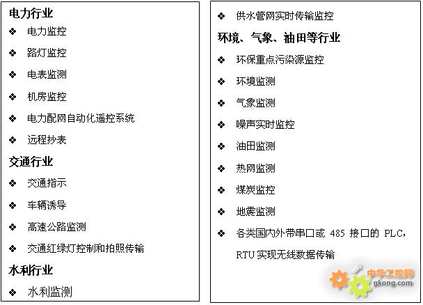

    ¸Ã²úÆ·Òѹ㷺ӦÓÃÓÚµçÁ¦¼¯Öг­±í¡¢Ë®±í¼¯Öг­±í¡¢ÈÈÍø¼à¿Ø¡¢È¼Æø¼à¿Ø¡¢Ë®Àû¼à¿Ø¡¢»·±£¼ì²â¡¢ÆøÏó¼ì²â¡¢µØÕð¼à²â£¬½»Í¨¿ØÖƵȵÈÐÐÒµ¡£

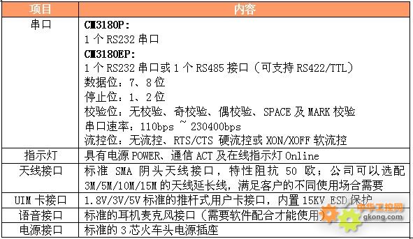

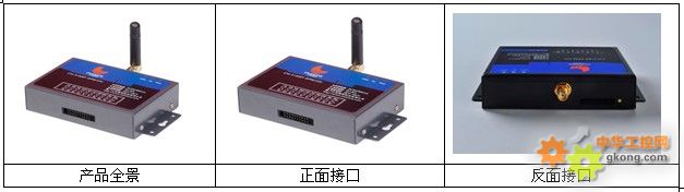

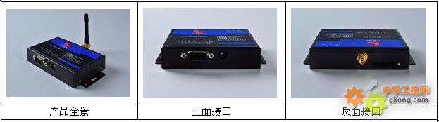

CM3180P²úÆ·½Ó¿Úͼ£º

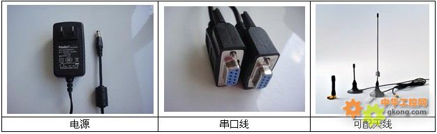

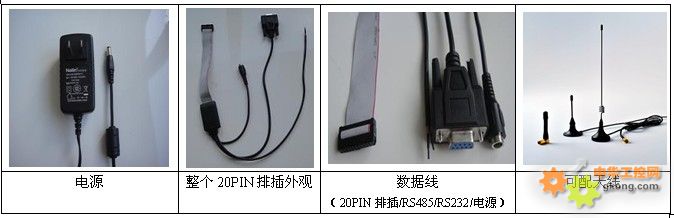

CM3180P²úÆ·Åä¼þͼƬ£º
CM3180EP²úÆ·½Ó¿Úͼ£º
CM3180EP²úÆ·Åä¼þͼƬ£º

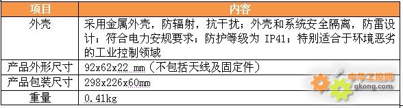

4.    ½ðÊôÍâ¿Ç£º²ÉÓýðÊôÍâ¿Ç£¬·À·øÉ䣬¿¹¸ÉÈÅ£»Íâ¿ÇºÍϵͳ°²È«¸ôÀ룬·ÀÀ×Éè¼Æ£»·ûºÏµçÁ¦°²¹æÒªÇó£»·À»¤µÈ¼¶ÎªIP41£»ÌرðÊʺÏÓÚ»·¾³¶ñÁӵĹ¤Òµ¿ØÖÆÁìÓò¡£

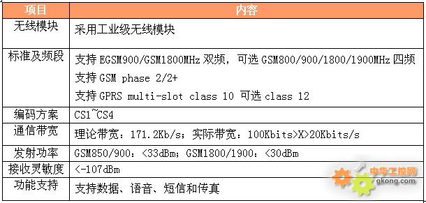

5.    ÍêÉÆµÄÍøÂçÖ§³Ö£ºÌṩ°üÀ¨2GÍøÂ磨GSMÍøÂ磩£¬2.5GÍøÂ磨GPRSÍøÂ磩£¬2.75GÍøÂ磨EDGEÍøÂ磩£¬3GÍøÂ磨WCDMAÍøÂç¡¢EVDOÍøÂç¡¢TD-SCDMAÍøÂ磩£¬4GÍøÂ磨HSPA+ÍøÂç¡¢LTEÍøÂ磩£¬È«ÍøÂçµÄ²úÆ·Ö§³Ö¡£

Èý¡¢¼¼Êõ²ÎÊý
ÎÞÏß²ÎÊý£º
Ó²¼þϵͳ£º
²Ù×÷ϵͳ£º
½Ó¿ÚÀàÐÍ£º
¹©µçÇé¿ö£º
ÎïÀíÌØÐÔ£º
ÆäËû²ÎÊý£º

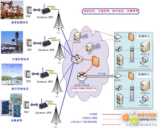

ËÄ¡¢²úÆ·Ó¦ÓÃÁ´½Óͼ

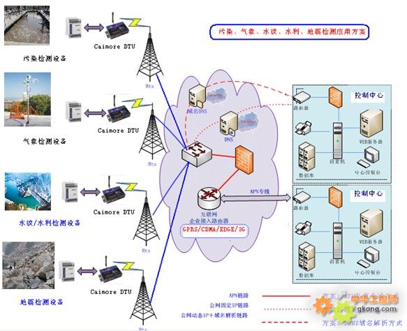

1¡¢  ¼ì²âÐÐÒµÓ¦Óã¨ÎÛȾ¡¢ÆøÏó¡¢Ë®ÎÆ¡¢Ë®Àû¡¢µØÕðµÈ£©

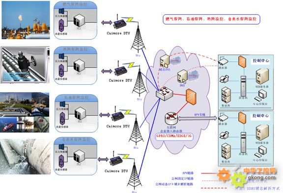

1¡¢  Íø¹Ü¼à¿ØÐÐÒµÓ¦Óã¨È¼Æø¹ÜÍø¡¢Ê¯Ó͹ÜÍø¡¢ÈÈÍø¼à¿Ø¡¢×ÔÀ´Ë®¹ÜÍø¼à¿ØµÈ£©
3.ÓÍÌï¼à¿Ø¡¢Â·µÆ¿ØÖÆ¡¢½»Í¨¿ØÖÆ¡¢³µÁ¾ÓÕµ¼

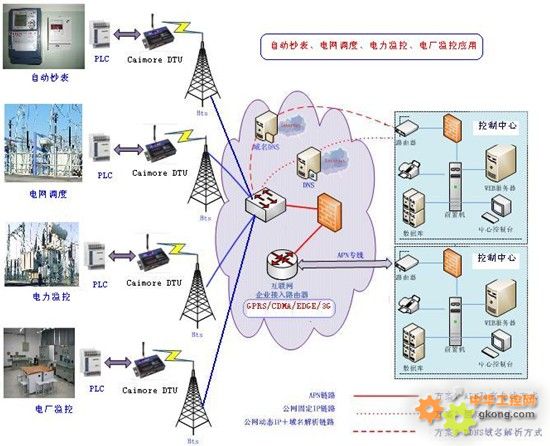

4. µçÁ¦ÐÐÒµÓ¦Óð¸Àý£¨Åäµç¼à¿Ø¡¢µçÍø×Ô¶¯»¯¡¢×Ô¶¯³­±í¡¢µçÍøµ÷¶È£©
Îå¡¢µäÐÍÓ¦ÓÃ
