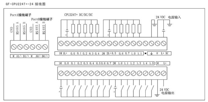

ͨѶ¶Ë¿Ú¶¨Òå
Á¬½ÓÆ÷
²åÕëºÅ
PORT0(RS485)
PORT1(RS485)
1
»ú¿Ç½ÓµØ
»ú¿Ç½ÓµØ
2
24VµØ
24VµØ
3
RS-485ÐźÅB
RS-485ÐźÅB
4
RTS
RTS
5
Âß¼­µØ
Âß¼­µØ
6
+5V£¬100¦¸´®Áªµç×èÆ÷
7
+24V
+24V
8
RS-485ÐźÅA
RS-485ÐźÅA
9
NC
NC
Á¬½ÓÆ÷Íâ¿Ç
»ú¿Ç½ÓµØ
»ú¿Ç½ÓµØ
½ÓÏßͼ
