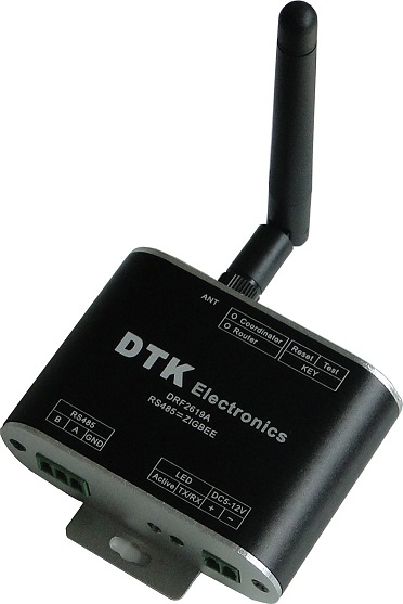

²úÆ·Ãû³Æ£º RS485תZigBeeÎÞÏßÄ£¿é£¨1.6¹«Àï´«Ê䣬CC2530оƬ£¬ZigBee2007£©
ÐÍ ºÅ£º DRF2619A
Æ· ÅÆ£º 6089
ZigbeeÄ£¿é
ÐͺţºDRF2619A£¬Ö÷Òª¹¦ÄÜ£ºRS485תZigBeeÎÞÏßÄ£¿é
¿ÉÊÓ´«Êä¾àÀ룺1.6¹«Àï
Óë DRF1605H ¹¦ÄÜÍêȫһÑù
²úÆ·Ö÷ÒªÌØµã
²úÆ·ÄÚ²¿ÒÔ±¾¹«Ë¾ZigBeeÄ£¿éDRF1605HΪºËÐÄת½ÓRS485µ×°å×éºÏ¶ø³É£¬Íâ¿ÇÈ«ÂÁºÏ½ð²ÄÖÊ¡£
Ïêϸ¹¦Äܼ°Ìصã¼ûZigBeeÄ£¿éDRF1605H
Ö÷Òª²ÎÊý

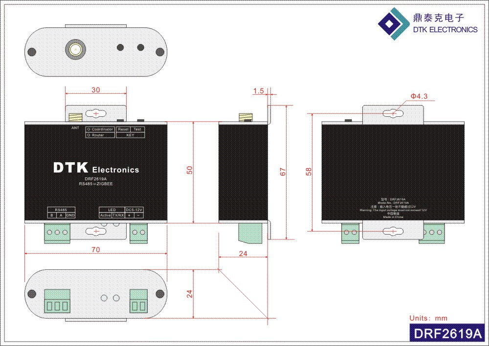

³ß´ç£º70*50*24mm£¨²»º¬ÌìÏß¡¢¹Ì¶¨¿×¼°½Ó¿Ú³ß´ç£©
ζȷ¶Î§£º-40¡æ¡«85¡æ
´®¿ÚËÙÂÊ£º¿Éµ÷£¨ÅäºÏZigBeeÄ£¿éµÄ´®¿ÚËÙÂÊΪ9600,19200,38400,57600,115200¿ÉÑ¡£©
¹©µç£ºµçѹDC5¡«12V£¬µçÁ÷>300mA
½Ó¿Ú¼°°´¼ü£ºSMAÌìÏß½ÓÍ·£¨ÍâÂÝÄÚ¿×£©£»RS485½Ó¿Ú£»2PINµçÔ´½Ó¿Ú£»¶þ¸öLED£»Ò»¸öTEST°´¼ü£¬Ò»¸öRESET°´¼ü¡£
¾»ÖØ£º80.5g£¨º¬ÌìÏߣ©
Íâ¹Û¼°³ß´ç½á¹¹Í¼

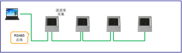

µäÐ͵ÄRS485ÍøÂçÒ»°ãÓÉÒ»¸öÖ÷»ú£¨µçÄÔ£¬PLC£¬¹¤¿Ø»ú£¬ÌØÊâÉ豸µÈ£©¼ÓN¸öÊý¾Ý²É¼¯»òÖ´ÐÐÉ豸¹¹³É£¬Ö÷»ú·¢ÃüÁîÂÖѯÉ豸£¬Ó¦ÓÃMODBUS RTUЭÒ飬ÈÕǰ£¬ÎÒÃǽ«Ò»¸öÓÐÏßµÄÎÂʪ¶È²É¼¯ÏµÍ³¸ÄÔì³ÉZigbeeÎÞÏ߲ɼ¯ÏµÍ³£¬¼òÊöÈçÏ£º
ϵͳÓÐÏß¹¹³É·½Ê½£º£¨²¨ÌØÂÊ9600, ´®¿Ú¸ñʽ£º8-N-1£¬MODBUS RTUЭÒ飩£º

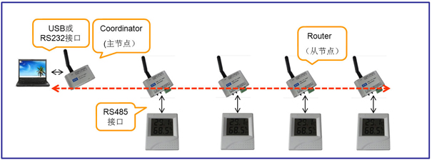

£¨1£©£¬ÔÚÉÏλ»ú½ÓÒ»¸öZigbeeÄ£¿é£¨USB»òRS232½Ó¿Ú£©£¬É趨ΪCoordinator£¬²¨ÌØÂÊ9600£»
£¨2£©£¬Ã¿¸öÉ豸½ÓÒ»¸öZigbeeÄ£¿é£¨RS485½Ó¿Ú£©£¬É趨ΪRouter£¬²¨ÌØÂÊ9600£»
£¨3£©£¬¸ÄÔìÍê³É£¬²»ÐèÒªÐÞ¸ÄÒÑÓеÄÈí¼þ¡£
£¨ÉèÖÃÆµµÀ£¬PAN ID£¬²¨ÌØÂÊ£¬½ÚµãÀàÐÍ£¬Çë²Î¿¼ZigbeeÄ£¿éʹÓÃÊֲᣩ
×¢ÒâÊÂÏÖ÷»ú·¢ËÍÖ¸ÁîÒªÇó¿ØÖÆÔÚÉÙÓÚ48×Ö½Ú£¨ÊµÑéÊÒÌõ¼þ64×Ö½Ú£©£¬É豸»Ø¸´ÉÙÓÚ128×Ö½Ú£¨ÊµÑéÊÒÌõ¼þ256×Ö½Ú£©¡£

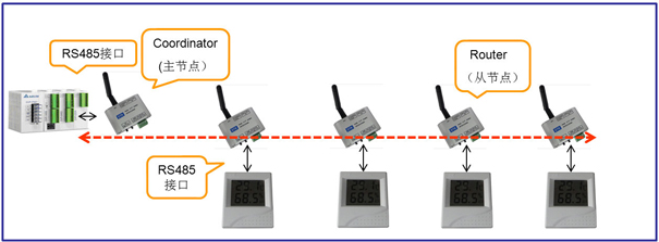

Èç¹ûÊÇPLC×÷ΪÖ÷»ú£¬¸ÄÔìºóÈçÏÂͼ£º
ÏÂͼÖУ¬Ö÷»ú£¨PLC£©½Ó485Ä£¿é£¬ÔòË«ÏòÊý¾Ý´«ÊäÒªÇóÉÙÓÚ48×Ö½Ú£¨ÊµÑéÊÒÌõ¼þ64×Ö½Ú£©

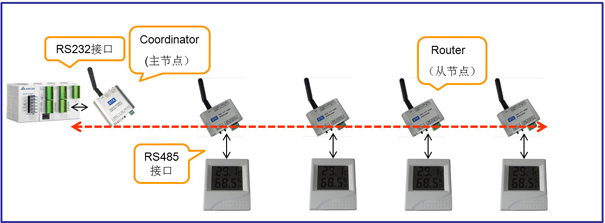

Èç¹ûPLCÓëRS232Ä£¿éÁ¬½Ó£¬ÈçÏÂͼ£¬ÔòÏÂÐÐ×î¶à48×Ö½Ú£¨ÊµÑéÊÒ64×Ö½Ú£©£¬ÉÏÐÐ128×Ö½Ú£¨ÊµÑéÊÒ256×Ö½Ú£©
