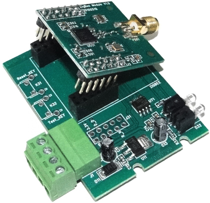

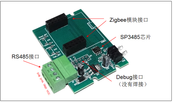

ZigbeeÄ£¿é RS485µ×°å
ÐͺţºDRF1605-RS485£¬Ö÷Òª¹¦ÄÜ£ºRS485תUART£¬ÅäºÏDRF1605ʹÓÃ
Ö÷ÒªÌØµã
¹¦ÄÜ£º¸Ãµ×°åΪRS485תUART£¬ÅäºÏ±¾¹«Ë¾ZigBeeÄ£¿é£¨DRF1605£©Ê¹Ó㬿ɽ«DRF1605½Ó¿Úת»»Îª±ê×¼µÄ°ëË«¹¤RS485½Ó¿Ú¡£
¹©µçµçѹ£ºDC5--12V
Ö÷Òª²ÎÊý

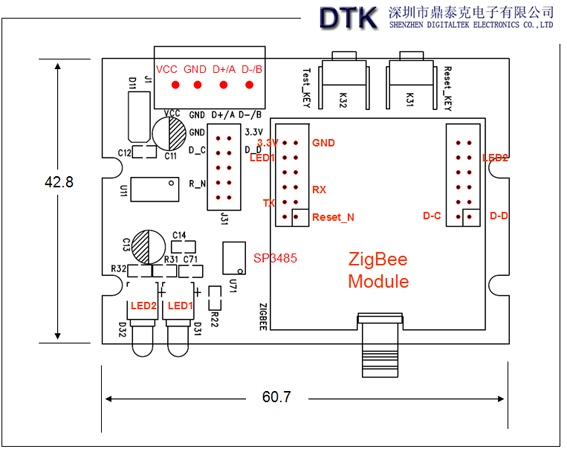

³ß´ç£º60.7*42.8*14mm£¨ÕûÌå³ß´ç£©
RS485½Ó¿Ú£º
ζȷ¶Î§£º-40C --85C
´®¿ÚËÙÂÊ£º¿Éµ÷£¨ÅäºÏZigBeeÄ£¿éµÄ´®¿ÚËÙÂÊΪ9600,19200,38400,57600,115200¿ÉÑ¡£©
¹©µç£ºµçѹDC5--12V£¬µçÁ÷<50MA
À©³ä½Ó¿Ú£ºÒý³öZigBeeÄ£¿éµÄDebug½Ó¿Ú£¨ÓëTI±ê×¼¹¤¾ß¼æÈÝ£¬ÈçCC-Debug£¬CC2530EB£¬ CC2430EBµÈ£©¡£¶þ¸öLED¡£
Òý½Å˵Ã÷
