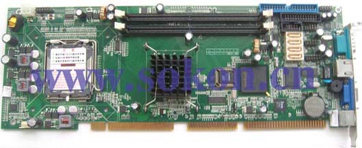

²úÆ·Ãû³Æ£º È«³¤CPU¿¨SK-945AVE
ÐÍ ºÅ£º SK-945AVE
SK-945AVE
   ÌØ µã:
²   Socket LGA775½á¹¹
²   Ö§³ÖIntel Core 2 Duo/ Pentium D/ Celeron D/ Pentium 4
²   1¸öIntel82562ET 10/100Õ×Íø¿¨
²  AC97 Éù¿Ú
²   Intel 945G¼¯³ÉGMA950ÏÔʾ
²   SATA x 4, USB 2.0 x 6, COM ¿Ú x 2
    ¼ò ½é :
Intel 945G + Intel ICH7оƬ×é;Ö§³ÖIntel Core 2 Duo/ Pentium D/ Celeron D/ Pentium 4 ;1¸öIntel82562ET 10/100Õ×Íø¿¨;6 x USB 2.0 (by pin header); AC97 Éù¿Ú;SATA x 4, USB 2.0 x 6, COM ¿Ú x 2;75Hzʱ£¬×î¸ß·Ö±æÂÊ¿ÉÒÔ´ï µ½2048¡Á1536µÄ32Î»Õæ²ÊÏÔʾ£¬85Hzʱ£¬Îª1600¡Á1200µÄ32Î»Õæ²ÊÏÔʾ
    ¹æ ¸ñ:
 ½á ¹¹
±ê×¼PICMG 1.0È«³¤¿¨
  CPUÀàÐÍ
Socket LGA775,Ö§³ÖIntel Core 2 Duo/ Pentium D/ Celeron D/ Pentium 4 processor LGA775 socket, w/ 1066/800/533MHz FSB,×î´óÖ§³Ö3.8GH
  ÄÚ  ´æ
2 x 240-Pin DIMM,×î´óÖ§³Ö   2GB ˫ͨµÀ   DDRII SDRAM
  Ð¾Æ¬×é
  ÏÔ  Ê¾
¼¯³ÉIntel. ExtremeͼÐμÓËÙ¿ØÖÆÆ÷£¬400 MHzºËÐÄËÙ¶È£¬ÏȽø µÄ2DºÍ3DͼÐÎÐÔÄÜÒÔ¼°¶¯»­¼ÓËÙÄÜÁ¦¡£75Hzʱ£¬×î¸ß·Ö±æÂÊ¿ÉÒÔ´ï µ½2048¡Á1536µÄ32Î»Õæ²ÊÏÔʾ£¬85Hzʱ£¬Îª1600¡Á1200µÄ32Î»Õæ²ÊÏÔʾ
  Íø  Âç
  USB½Ó¿Ú
  Òô  Æµ
 AC97 Éù¿Ú
  ÆäËüI/O½Ó¿Ú
2 x COM port (RS-232) ;1 x SPP/EPP/ECP mode
PS/2¼üÅÌ¡¢Êó±ê½Ó¿Ú
  SATA½Ó¿Ú
4 x Serial ATA II with 300MB/s
  IDEÉ豸
1¸ö40PIN IDE½Ó¿Ú
  ¿´ÃŹ·
Óû§¿É±à³Ì£¬¶¨Ê±Ê±¼ä¿ÉÑ¡Ôñ1-255Ãë»ò1-255·ÖÖÓ
  µç×ÓÅÌ
Ö§³ÖIDE½Ó¿ÚDOM
  Ó²¼þ¼à²â
ÄÚ½¨ÏµÍ³Ó²¼þ¼à²âµç·£¬¶¯Ì¬¼à²âCPUζȡ¢ÏµÍ³Î¶ȡ¢·çÉÈ״̬¡¢µçѹÊä³öµÈ״̬
  ISAÇý¶¯
ISA×ÜÏ߸ßÇý¶¯ÄÜÁ¦
  ¹¤×÷ζÈ
0¡«60¡æ
  ´¢´æÎ¶È
-20¡«80¡æ
  ¹¦  ºÄ
