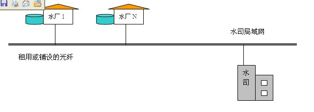

¹©Ë®¹¤³Ì×Ô¶¯»¯¼à¿ØÏµÍ³ÊÇˮ˾Éú²úµ÷¶È¹ÜÀíϵͳµÄÒ»¸ö×Óϵͳ£¬Ö÷ÒªÓÉˮ˾µ÷¶ÈÖÐÐÄ¡¢Ë®³§¼à¿ØÖÐÐÄ¡¢Í¨ÐÅÆ½Ì¨¡¢¼Óѹ±Ã×é²â¿ØÖÕ¶Ë¡¢ÅäµçÉ豸¼à²âÖÕ¶Ë×é³É¡£
ͨÐÅÆ½Ì¨£º
ˮ˾µ÷¶ÈÖÐÐÄ¡¢¸÷Ë®³§¡¢¸÷Ö°Äܲ¿ÃÅÖ®¼äÊý¾ÝͨÐÅÔÚ¾ÖÓòÍøÄÚÍê³É£»Ë®³§Óëµ÷¶ÈÖÐÐÄÖ®¼äÒ»°ã×âÓûòÆÌÉè¹âÏË¡£
