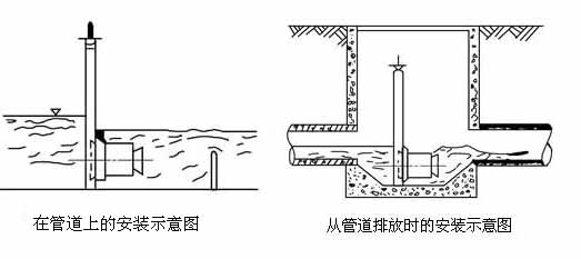

ËÄ¡¢Ç±Ë®µç´ÅÁ÷Á¿¼Æ°²×°Î»ÖõÄÑ¡Ôñ
DZˮµç´ÅÁ÷Á¿¼Æ°²×°Ê¾Òâͼ
