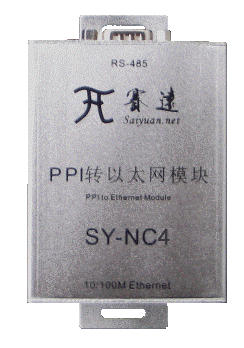

²úÆ·Ãû³Æ£º SY-NC4´®¿ÚPPIתÒÔÌ«ÍøÄ£¿é
ÐÍ ºÅ£º SY-NC4
SY-NC4ÊÇÎ÷ÃÅ×ÓS7-200 PLC±¾»úPPIͨѶ½Ó¿Úת»»Æ÷£¬¾ßÓа²×°¼òµ¥£¬ÐÔÄÜÎȶ¨£¬Ê¹Ó÷½±ã£¬¹¦ºÄ¼«µÍÖ®ÌØµã£¬SY-NC4Ö±½Ó´ÓMPI´®¿ÚÈ¡µç£¬ÎÞÐè¶îÍ⹩µç¡£
SY-NC4½«PPIЭÒéת»»ÎªTCP/IPЭÒ飬¿ÉÓë¼ÆËã»úµÄ¸÷ÖÖÉÏλ×é̬Èí¼þÁ¬½Ó£¬ÈçWinCC¡¢Intouch¡¢KEPServerEX¡¢Ò׿صȣ¬Ò²¿ÉÒÔͨ¹ýÎ÷ÃÅ×Ó±à³ÌÈí¼þStep7 MicrowinV4.0¶ÔÎ÷ÃÅ×ÓS7-200 PLC½øÐбà³Ì£¬²¢×Ô¶¯¼ì²âºÍÊÊÓ¦²¨ÌØÂÊ¡£ÓëÎ÷ÃÅ×ÓÒÔÌ«ÍøÍ¨Ñ¶´¦ÀíÆ÷CP243-1¹¦ÄÜÏàͬ£¬ÊÇÒ»¿î¾ßÓиßÐԼ۱ȵIJúÆ·¡£
Ïà¶ÔÓÚCP243-1ÒÔÌ«ÍøÄ£¿éÀ´Ëµ£¬IPµØÖ·Êǹ̶¨ÔÚSY-NC4ÉÏ£¬ËùÒÔºÍS7-200ÅäºÏʹÓÃʱ£¬²»Ðèµ£ÐÄÒòΪÍü¼ÇÅäÖÃÒÔÌ«ÍøÄ£¿é¶øÁ¬½Ó²»ÉÏ¡£
¼¼Êõ²ÎÊý:
¨¹        ÍâÐγߴ磺80*70*60 mm£¬Ìå»ýС£¬±ãÓÚ°²×°£»
¨¹        µçÔ´¹©µç£º24VDC£¬50mA£¬Ö±½Ó´ÓS7-200µÄPPI´®¿Ú¹©µç£»
¨¹        Ò»¸öRS485´®¿Ú£¬Á¬½ÓPLC£»
¨¹        Ò»¸öRJ45½Ó¿Ú£¬Á¬½ÓPC»òÕ߯äËû¾ßÓÐÒÔÌ«ÍøµÄÉ豸£»
¨¹        ²ÉÓøßÐÔÄܵĹ¤ÒµIC£¬¿¹¸ÉÈÅÐÔÄܺã»
¨¹        ÖØÁ¿£º110¿Ë£»
¨¹        ¹¤×÷ζȣº0~+50¡æ£»
¨¹        ´¢´æÎ¶ȣº-20~+60¡æ£»
¨¹        ·À»¤µÈ¼¶£ºIP20£»
¨¹        ×î´óÏà¶Ôʪ¶È£º90%£»
¨¹        ³ö³§Ä¬ÈϹ̶¨IPµØÖ·£º192.168.1.198£»
¨¹        ÅäÖ÷½Ê½£ºWebä¯ÀÀÆ÷£»
¨¹        Ö§³ÖµÄPPI×ÔÊÊÓ¦²¨ÌØÂʲÎÊýΪ£º9600bps£¬19200bps£¬187.5Kbps¡£
