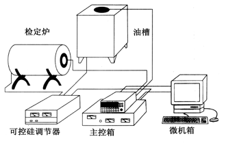

JD8051-CÈȹ¤×Ô¶¯¼ì¶¨ÏµÍ³Óɸ߾«¶ÈÊý×Ö¶àÓÃ±í¡¢Ö÷¿ØÏä¡¢¿É¿Ø¹èµ÷½ÚÆ÷¡¢Î¢»úϵͳ¡¢ºãÎÂ×°Ö㨼춨¯ºÍÓͲۣ©ÒÔ¼°²âÁ¿µ¼ÏߺÍͨѶµ¼Ïß×é³É£¬ÈçͼËùʾ¡£
