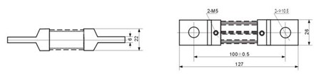

ËÄ£ºÍâ¹Û³ß´çͼ£º
  ²úÆ·ÐͺÅ
                           ²úÆ·°²×°³ß´ç
FL-2£¨1£­50A£©
FL-2£¨100A£©
FL-2£¨200A£©
FL-2£¨300A£©
