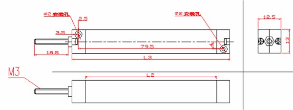

²úÆ·Ãû³Æ£º
À¸ËÊ½Î»ÒÆ´«¸ÐÆ÷
ÐÍ ºÅ£º
KTS
0.00
Íâ¹Û³ß´çͼ£º
KTSÌØÐÔ±í |
¹æ¸ñ |
10mm |
25mm |
50mm |
75mm |
100mm |
ÓÐЧÐÐ³Ì |
11mm |
26mm |
51mm |
76mm |
101mm |
»úеÐÐ³Ì |
12mm |
27mm |
52mm |
77mm |
102mm |
L1 |
25mm |
40mm |
65mm |
90mm |
115mm |
L2 |
31mm |
46mm |
71mm |
96mm |
121mm |
L3 |
47mm |
62mm |
87mm |
112mm |
137mm |
×Ü×è |
5K¦¸ |
×èÖµÎó²î |
¡À20% |
¶ÀÁ¢ÏßÐÔÂÊ |
0.25% |
ÖØ¸´¾«¶È |
0.01mm |
ζÈϵÊý |
50ppm/¡æ |
Êä³öƽ»¬ÐÔ |
¡À0.1% |
ÊÙÃü |
Ò»ÒÚ´Î |
¹¦ÂÊÏûºÄ |
×î´ó0.5W |
¹¤×÷ÎÂ¶È |
-40-100¡æ |
