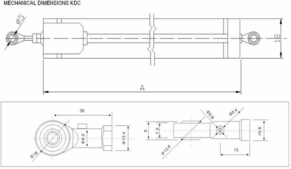

²úÆ·Ãû³Æ£º
½Â½ÓÊ½Î»ÒÆ´«¸ÐÆ÷
ÐÍ ºÅ£º
KDC
0.00
»úе³ß´ç£º
KDCµç×Ó³ßÌØÐÔ±í |
ÐͺŠ|
Unit |
10 |
25 |
50 |
75 |
100 |
125 |
150 |
175 |
200 |
225 |
250 |
275 |
300 |
400 |
Á¿³Ì |
mm |
10 |
25 |
50 |
75 |
100 |
125 |
150 |
175 |
200 |
225 |
250 |
275 |
300 |
400 |
µçÆøÐгÌ(T.E) |
mm |
13 |
28 |
53 |
78 |
103 |
128 |
153 |
178 |
203 |
228 |
253 |
278 |
303 |
403 |
mm |
115 |
130 |
155 |
180 |
205 |
230 |
255 |
280 |
305 |
330 |
355 |
380 |
405 |
505 |
µç×è |
K¦¸ |
1 |
1 |
5 |
5 |
5 |
5 |
5 |
5 |
5 |
5 |
5 |
5 |
5 |
5 |
µç×èÎó²î |
¡À% |
20 |
ÏßÐÔ¶È |
0.1 |
0.1 |
0.09 |
0.08 |
0.08 |
0.08 |
0.08 |
0.07 |
0.07 |
0.06 |
0.06 |
0.05 |
0.05 |
0.05 |
ÖØ¸´¾«¶È |
mm |
0.01 |
ÍÆ¼öµçË¢µçÁ÷ |
¦ÌA |
1 |
µçË¢×î´óµçÁ÷ |
mA |
10 |
×î´ó¹¤×÷µçѹ |
V |
42 |
ÐźÅÊä³ö |
0-5V,0-10V,¡À5V,4-20mA |
·Ö±æÂÊ |
infinite |
Êä³öƽ»¬¶È |
0.1 |
¾øÔµµç×è |
M¦¸ |
¡Ý10 |
ζÈϵÊý |
ppm/k |
5 |
³ß´ç A |
mm |
50 |
65 |
90 |
115 |
140 |
165 |
190 |
215 |
240 |
265 |
290 |
315 |
340 |
440 |
»úеÐгÌ(M.T) |
mm |
15 |
30 |
55 |
80 |
105 |
130 |
155 |
180 |
205 |
230 |
255 |
280 |
305 |
405 |
Çý¶¯Á¦ |
N |
¡Ü3 |
¹¤×÷ÎÂ¶È |
¡æ |
-60¡¤¡¤¡¤¡¤¡¤¡¤150 |
Õñ¶¯ÆµÂÊ |
Hz |
5¡¤¡¤¡¤¡¤¡¤¡¤2000 |
Õñ·ù |
mm |
0.8 |
¼ÓËÙ¶È |
g |
20 |
ÊÙÃü |
cycle |
10¡Á106 |
¹¤×÷ËÙ¶È |
m/s |
¡Ü10 |
