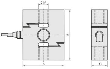

ÍâÐγߴç(mm)£º
Á¿³Ì
t
1¡«1.5
2¡«5
7.5¡«10
20
klb
2¡«3
5¡«10
15¡«20
40
M
¹«ÖÆ
M12*1.75
M18*1.5
M30*2
M39*2
Ó¢ÖÆ
1/2-20UNF
3/4-16UNF
5/4-12UNF
3/2-12UNF
A
70
95
125
150
B
80
108
175
188
C
25
25
60
