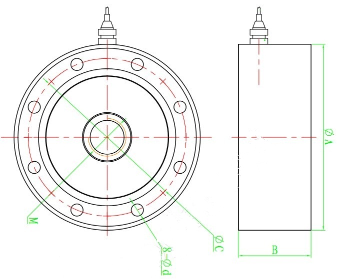

²úÆ·Ãû³Æ£º ³ÆÖزâÁ¦´«¸ÐÆ÷¡¢Ñ¹Á¦´«¸ÐÆ÷
ÐÍ ºÅ£º PLD204A
Æ· ÅÆ£º 8788
À­Á¦´«¸ÐÆ÷¡¢À­Ñ¹Á¦´«¸ÐÆ÷¡¢²âÁ¦´«¸ÐÆ÷¡¢Ñ¹Á¦´«¸ÐÆ÷¡¢Á¦´«¸ÐÆ÷
½ÓÏß·½Ê½£º
ºì ÊäÈë+     ºÚ ÊäÈë-      °× Êä³ö-      ÂÌ Êä³ö+
µçÀÂÏß²ÉÓÃËÄоÆÁ±ÎµçÀÂ(¦Õ5x3000mm)¡£

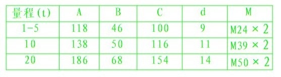

¼¼Êõ²ÎÊý£º
¶î¶¨ÔغɠRated capacities(Emax)
0.5¡¢1¡¢2¡¢3¡¢5¡¢10¡¢20T
Êä³öÁéÃô¶È Rated output
2.0(3.0)¡À10%mV/V
×ÛºÏÎó²î Total error
0.05~0.1%F.S
·ÇÏßÐÔ Non-linearity
0.05%F.S
Öͺó Hysteresis
0.05%F.S
ÖØ¸´ÐÔ Repeatability
0.05%F.S
Èä±ä(30·ÖÖÓ)Creep(30min)
0.05%F.S
ÁãµãÊä³öZero balance
¡À2%F.S
ÁãµãÎÂ¶ÈÆ¯ÒÆ Temperature effect on zero
¡À0.05%F.S/10¡æ
ζÈÁéÃô¶ÈÆ¯ÒÆ Temperature effect on out
¡À0.05%F.S/10¡æ
ÊäÈë×迹 Input resistance
385¡À10¦¸
Êä³ö×迹 Output resistance
350¡À5¦¸
¾øÔµµç×è Insulation resistance
¡Ý5000M¦¸/100DC
¶È²¹³¥·¶Î§ Compensated Temperature range
-10¡«+50¡æ
¹¤×÷ζȷ¶Î§ Operation Temperature range,
-35~+65 ¡æ
°²È«¹ýÔØ Maximum safe overload
120 %F.S
¼«ÏÞ¹ýÔØ Ultimate overload
200 %F.S
ÍÆ¼ö¼¤Àøµçѹ Excitation,recommend
5-10V DC
×î´ó¼¤Àøµçѹ Excitation,maximum
15V DC
·À·âµÈ¼¶ Protection Class
IP66
µçÀ³ߴç Cable size
¦µ2.5¡Á3000mm
