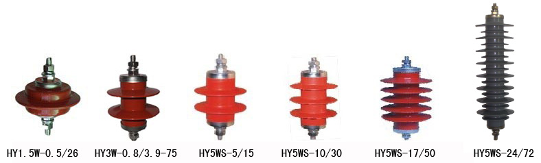

| ÅäµçÐÍ¡¢HY5WZµçÕ¾ÐͱÜÀׯ÷ |
µÍѹÐÍ ÓÃÓÚ±£»¤ÏàÓ¦µÈ¼¶µÄÅäµçÉ豸ÃâÊܴ󯸵IJÙ×÷¹ýµçѹµÄË𻵡£ |
±ÜÀׯ÷ÐͺŠ|
