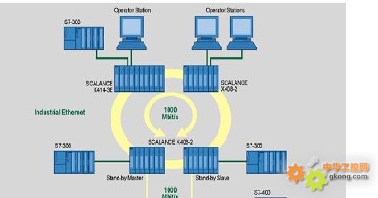

SCALANCE X414-3E
²úÆ·ÃèÊö
¶©»õºÅ£º6GK5414-3FC00-2AA2
ÐÍ    ºÅ£º SCALANCE X414-3E£¬»ù±¾Ä£¿é´øÓÐ2¸ö10/100/1000Mbit/SºÍ12¸ö10/100Mbit/s RJ45¶Ë¿Ú£¬1¸öǧÕ×/°ÙÕ×½éÖÊÄ£¿é²å²Û£¬2¸ö°ÙÕ×¹âÏ˽éÖʲå²Û£¬×ÛºÏÈßÓà¹ÜÀí£¬Èý²ã·Óɹ¦ÄÜ£¬°ì¹«ÊÒÍøÂ繦ÄÜ£¨RSTP,VLAN,…£©£¬ÍøÂç¹ÜÀí£¬´øÓÐ C-Plug
´«ÊäËÙÂÊ£º10/100/1000Mbit/s
½Ó¿ÚÀàÐÍ
µç    Æø: ÔÚ»ù±¾Ä£¿éÉÏ£º
2×RJ45½Ó¿Ú£¨10/100/1000Mbit/s;TP£©
12×RJ45½Ó¿Ú£¨10/100Mbit/s;TP£©
Ôö¼ÓÀ©Õ¹Ä£¿é£º
ͨ¹ýEM495-8Ä£¿é¿ÉÔö¼Ó8×RJ4½Ó¿Ú£¨10/100Mbit/s;TP£©
¹â    ѧ£ºÔÚ»ù±¾Ä£¿éÉÏ£º
ͨ¹ýÅäÖÃMM492-2»òMM492-2LD½éÖÊÄ£¿é¿É»ñµÃ2¸öǧÕ×¹âÏËSC½Ó¿Ú£»Í¨¹ýÅäÖÃMM492-1»òMM491-2LD½éÖÊÄ£¿é¿É»ñµÃ4¸ö°ÙÕ×¹âÏËBFOC½Ó¿Ú
Ôö¼ÓÀ©Õ¹Ä£¿é£º
ͨ¹ýÔö¼ÓEM496-4À©Õ¹Ä£¿éºÍMM41-2»òMM491-2LD½éÖÊÄ£¿é¿É»ñµÃ12¸ö°ÙÕ×SC½Ó¿Ú
À©Õ¹½Ó¿Ú£ºEM495-8»òEM496-4
µçÔ´Á¬½Ó£º1×4Õë¶Ë×ÓÅÅ
ÐźŴ¥·¢Á¬½Ó£º1×4Õë¶Ë×ÓÅÅ
Êý×ÖÐźÅÊäÈ룺2×5Õë¶Ë×ÓÅÅ
½»»»½éÖʲå²Û£ºC-PLUG
µçÔ´µçѹ£º2×24V DC£¨18V to 32V£©
µçÁ÷ÏûºÄ£º£¼2000mA
¹¦    ÂÊ£º15 W£¨²»°²×°½éÖÊÄ£¿éʱ£©
          £¼48W£¨×î´óÅäÖÃʱ£©
ÍøÂ緶Χ²ÎÊý/Ë«½ÊÏßÀ³¤¶È£º
0-100Ã×£º´øÓй¤Òµ¿ìËÙÁ¬½ÓRJ45²åÍ·µÄ¹¤Òµ±ê×¼µçÀÂ
0- 85Ã×£º´øÓй¤Òµ¿ìËÙÁ¬½ÓRJ45²åÍ·µÄ¹¤Òµ´¬ÓÃ/ÍÏÀÂ
0- 55Ã×£º´øÓй¤Òµ¿ìËÙÁ¬½ÓRJ45²åÍ·µÄ¹¤ÒµÅ¤×ªË«½ÊÏß
0- 3000Ã×£º°ÙÕ×¶àÄ£¹âÏ˵Ĵ«Êä¾àÀ룻MM491-2ʹÓò£Á§¹âÏ˵Ĺæ¸ñ
          62.5/125μm»ò50/125μm£»≤1dB/km 1300nm²¨³¤£»≥600MHz×km
0- 750  Ã×£ºÇ§Õ×¶àÄ£¹âÏ˵Ĵ«Êä¾àÀ룻MM492-2ʹÓò£Á§¹âÏ˵Ĺæ¸ñ
          50/125μm£»≤2.7dB/km 850nm²¨³¤£»≥600MHz×km
0- 26 ǧÃ×£º°ÙÕ×µ¥Ä£¹âÏ˵Ĵ«Êä¾àÀ룻MM491-2ʹÓò£Á§¹âÏ˵Ĺæ¸ñ
          10/125μm»ò9/125μm£»≤0.5dB/km 1300nm²¨³¤
0- 10 ǧÃ×£ºÇ§Õ×µ¥Ä£¹âÏ˵Ĵ«Êä¾àÀ룻MM492-2 LDʹÓò£Á§¹âÏ˵Ĺæ¸ñ
¹¤×÷»·¾³Ìõ¼þ
¹¤×÷ζȣº£­20°CÖÁ+70°C
ÔËÊä/´æ´¢Î¶ȣº£­40°CÖÁ+80°C
¹¤×÷ʪ¶È£º£¼95%£¬ÎÞÄý½á
»úе½á¹¹
³ß´ç(W×H×D)mm:344×145×112
ÖØ     Á¿£º3.1Kg
°²×°·½Ê½£ºS7-300×éºÏµ¼¹ì£¬DINµ¼¹ì
·À»¤µÈ¼¶£ºIP20
ÈÏ    Ö¤
ÔëÉù·øÉ䣺EN 61000-6-4 Class A
¿¹¸ÉÈÅÐÔ£ºEN 61000-6-2
CuL listing: UL 60950-1,CSA C22.2 Nr.60950-1
             UL 508,CSA C22.2 Mr.14-M91
             UL 1604 und 2279(Hazardous Location)
FM      : FM 3611,FM Hzazrdous Location
ATEX Zone 2: EN 50021
C-Tick : AS/NZS 2064 (Class A)
CE      : EN 61000-6-4 ,EN 61000-6-2
´¬¼¶ÉçÈÏÖ¤
          ÃÀ¹ú½¢Í§Ð­»á
          Ó¢¹úÀÍÊÏ´¬¼¶Éç
          ŲÍþ´¬¼¶Éç
          µÂ¹úÀÍÊÏ´¬¼¶Éç
          ÈÕ±¾º£ÊÂЭ»á
          ·¨¹ú´¬¼¶Éç
ƽ¾ùÎÞ¹ÊÕÏʱ¼ä£º24Äê
×é»·ÄÜÁ¦£ºÓÐ
ÈßÓà¹ÜÀíÆ÷¹¦ÄÜ£ºÓÐ
