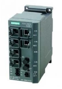

²úÆ·Ãû³Æ£º Íø¹ÜÐÍÎ÷ÃÅ×Ó½»»»»úSCALANCE X206-1LDÌØ¼Û
ÐÍ ºÅ£º 6GK5206-1BC10-2AA3
Æ· ÅÆ£º 1
²úÆ·ÃèÊö
¶©»õºÅ£º6GK5206-1BC10-2AA3
ÐÍ    ºÅ£ºSCALANCE X206-1LD,Íø¹ÜÐͽ»»»»ú6×10/100Mbit/s RJ45¶Ë¿Ú,1×100Mbit/sµ¥Ä£BFOC½Ó¿Ú,LEDÕï¶Ï£¬¹ÊÕÏÐźÅÏÔʾ£¬Á¬½ÓÉèÖð´Å¥£¬ÈßÓàµçÔ´ÊäÈ룬PROFINT IOÉè¼Æ£¬ÍøÂç¹ÜÀí£¬¿É×é³ÉÈßÓà»·£¬¿ÉÑ¡C-Plug,µç×ÓÊÖ²á¹âÅÌ
´«ÊäËÙÂÊ£º10/100Mbit/s
½Ó¿ÚÀàÐÍ
µç    Æø: 6×RJ45½Ó¿Ú£¨10/100Mbit/s;TP£©
¹â    ѧ£º1×BFOC½Ó¿Ú£¨100Mbit/s£©
µçÔ´Á¬½Ó£º1×4Õë¶Ë×ÓÅÅ
ÐźŴ¥·¢Á¬½Ó£º1×2Õë¶Ë×ÓÅÅ
½»»»½éÖʲå²Û£ºC-PLUG
µçÔ´µçѹ£º2×24V DC£¨18V to 32V£©
µçÁ÷ÏûºÄ£º215mA
¹¦    ÂÊ£º5.16 W
ÍøÂ緶Χ²ÎÊý/Ë«½ÊÏßÀ³¤¶È£º
0-100Ã×£º´øÓй¤Òµ¿ìËÙÁ¬½ÓRJ45²åÍ·µÄ¹¤Òµ±ê×¼µçÀÂ
ÓÃ0-90Ã×¹¤Òµ±ê×¼µçÀÂÁ¬½ÓµÄRJ45½Ó¿ÚµÄ²å×ù+10Ã×Ë«½ÊÏß
0- 85Ã×£º´øÓй¤Òµ¿ìËÙÁ¬½ÓRJ45²åÍ·µÄ´¬ÓÃ/ÍÏÀÂ
ÓÃ0-75Ã×´¬ÓÃ/ÍÏÀÂÁ¬½ÓµÄRJ45½Ó¿ÚµÄ²Ù×÷+10Ã×Ë«½ÊÏß
0- 55Ã×£º´øÓй¤Òµ¿ìËÙÁ¬½ÓRJ45²åÍ·µÄŤת˫½ÊÏß
ÓÃ0-45Ã׍ת˫½ÊÏßÁ¬½ÓµÄRJ45½Ó¿ÚµÄ²å×ù+10Ã×Ë«½ÊÏß
0-3000Ã×£º—
0-26000Ã×£º²ÉÓÃ10/125μmµ¥Ä£²£Á§¹âÏË£»0.5dB/km 1300nm²¨³¤
¹¤×÷»·¾³Ìõ¼þ
¹¤×÷ζȣº£­20°CÖÁ+70°C
ÔËÊä/´æ´¢Î¶ȣº£­40°CÖÁ+80°C
¹¤×÷ʪ¶È£º£¼95%£¬ÎÞÄý½á
»úе½á¹¹
³ß´ç(W×H×D)mm:60×125×124
ÖØ    Á¿£º780g
°²×°·½Ê½£º±ê×¼µ¼¹ì°²×°,S7-300µ¼¹ì£¬±Ú°å°²×°
·À»¤µÈ¼¶£ºIP30
ÈÏ    Ö¤
ÔëÉù·øÉ䣺EN 61000-6-4 Class A
¿¹¸ÉÈÅÐÔ£ºEN 61000-6-2
CuL listing: UL 60950-1,CSA C22.2 NO.60950-1
             Nr.60950-1
FM      : FM 3611
ATEX Zone 2: EN 50021
C-Tick : AS/NZS 2064 (Class A)
CE      : EN 61000-6-2,EN 61000-6-4
´¬¼¶ÉçÈÏÖ¤
          Ó¢¹úÀÍÊÏ´¬¼¶Éç
          ŲÍþ´¬¼¶Éç
          µÂ¹úÀÍÊÏ´¬¼¶Éç
          ÈÕ±¾º£ÊÂЭ»á
          ·¨¹ú´¬¼¶Éç
ƽ¾ùÎÞ¹ÊÕÏʱ¼ä£º110.44Äê
×é»·ÄÜÁ¦£ºÓÐ
ÈßÓà¹ÜÀíÆ÷¹¦ÄÜ£ºÓÐ
