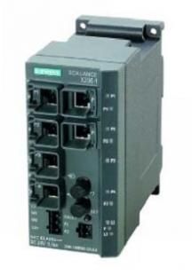

²úÆ·Ãû³Æ£º ½»»»»úSCALANCE X206-1ÈÈÏú
ÐÍ ºÅ£º 6GK5206-1BB10-2AA3
Æ· ÅÆ£º 1
Î÷ÃÅ×Ó½»»»»úÏÖ»õ´óÁ¿¹©Ó¦£¬ÊÇÄúµÄ×î¼ÑÑ¡Ôñ£¡
½»»»»úX206-1 ,¿ÉÍø¹ÜÐͽ»»»»ú£¬´ø6¸ö°ÙÕ׵ĵç¿Ú£¬1¸ö¹â¿Ú¡£
SCALANCE X206-1
²úÆ·ÃèÊö
¶©»õºÅ£º6GK5206-1BB10-2AA3
ÐÍ    ºÅ£ºSCALANCE X206-1,Íø¹ÜÐͽ»»»»ú6¡Á10/100Mbit/s RJ45¶Ë¿Ú,1¡Á100Mbit/s¶àÄ£BFOC½Ó¿Ú,LEDÕï¶Ï£¬¹ÊÕÏÐźÅÏÔʾ£¬Á¬½ÓÉèÖð´Å¥£¬ÈßÓàµçÔ´ÊäÈ룬PROFINT IOÉè¼Æ£¬ÍøÂç¹ÜÀí£¬¿É×é³ÉÈßÓà»·£¬¿ÉÑ¡C-Plug,µç×ÓÊÖ²á¹âÅÌ
´«ÊäËÙÂÊ£º10/100Mbit/s
½Ó¿ÚÀàÐÍ
µç    Æø: 6¡ÁRJ45½Ó¿Ú£¨10/100Mbit/s;TP£©
¹â    ѧ£º1¡ÁBFOC½Ó¿Ú£¨100Mbit/s£©
µçÔ´Á¬½Ó£º1¡Á4Õë¶Ë×ÓÅÅ
ÐźŴ¥·¢Á¬½Ó£º1¡Á2Õë¶Ë×ÓÅÅ
½»»»½éÖʲå²Û£ºC-PLUG
µçÔ´µçѹ£º2¡Á24V DC£¨18V to 32V£©
µçÁ÷ÏûºÄ£º200mA
¹¦    ÂÊ£º4.8 W
ÍøÂ緶Χ²ÎÊý/Ë«½ÊÏßÀ³¤¶È£º
0-100Ã×£º´øÓй¤Òµ¿ìËÙÁ¬½ÓRJ45²åÍ·µÄ¹¤Òµ±ê×¼µçÀÂ
ÓÃ0-90Ã×¹¤Òµ±ê×¼µçÀÂÁ¬½ÓµÄRJ45½Ó¿ÚµÄ²å×ù+10Ã×Ë«½ÊÏß
0- 85Ã×£º´øÓй¤Òµ¿ìËÙÁ¬½ÓRJ45²åÍ·µÄ´¬ÓÃ/ÍÏÀÂ
ÓÃ0-75Ã×´¬ÓÃ/ÍÏÀÂÁ¬½ÓµÄRJ45½Ó¿ÚµÄ²Ù×÷+10Ã×Ë«½ÊÏß
0- 55Ã×£º´øÓй¤Òµ¿ìËÙÁ¬½ÓRJ45²åÍ·µÄŤת˫½ÊÏß
ÓÃ0-45Ã׍ת˫½ÊÏßÁ¬½ÓµÄRJ45½Ó¿ÚµÄ²å×ù+10Ã×Ë«½ÊÏß
0-3000Ã×£º²ÉÓÃ62.5/125¦Ìm»ò50/125¦Ìm¶àÄ£²£Á§¹âÏË£»
           ¡Ü1.0dB/km 1300nm²¨³¤£»¡Ý600MHz¡Ákm
¹¤×÷»·¾³Ìõ¼þ
¹¤×÷ζȣº£­10¡ãCÖÁ+60¡ãC
ÔËÊä/´æ´¢Î¶ȣº£­40¡ãCÖÁ+80¡ãC
¹¤×÷ʪ¶È£º£¼95%£¬ÎÞÄý½á
»úе½á¹¹
³ß´ç(W¡ÁH¡ÁD)mm:60¡Á125¡Á124
ÖØ    Á¿£º780g
°²×°·½Ê½£º±ê×¼µ¼¹ì°²×°,S7-300µ¼¹ì£¬±Ú°å°²×°
·À»¤µÈ¼¶£ºIP30
ÈÏ    Ö¤
ÔëÉù·øÉ䣺EN 61000-6-4 Class A
¿¹¸ÉÈÅÐÔ£ºEN 61000-6-2
CuL listing: UL 60950-1,CSA C22.2 NO.60950-1
             Nr.60950-1
FM      : FM 3611
ATEX Zone 2: EN 50021
C-Tick : AS/NZS 2064 (Class A)
CE      : EN 61000-6-2,EN 61000-6-4
´¬¼¶ÉçÈÏÖ¤
          ¡ª
          Ó¢¹úÀÍÊÏ´¬¼¶Éç
          ŲÍþ´¬¼¶Éç
          µÂ¹úÀÍÊÏ´¬¼¶Éç
          ÈÕ±¾º£ÊÂЭ»á
          ·¨¹ú´¬¼¶Éç
ƽ¾ùÎÞ¹ÊÕÏʱ¼ä£º110.47Äê
×é»·ÄÜÁ¦£ºÓÐ
ÈßÓà¹ÜÀíÆ÷¹¦ÄÜ£ºÓÐ
