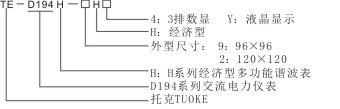

 Ðͺż°º¬Òå
 ¸Å Êö
      TE-D194HϵÁо­¼ÃÐͶ๦ÄÜг²¨±í¿É²âÁ¿¸÷ÖÖ³£ÓõçÁ¦²ÎÊý¡¢ÓÐÎÞ¹¦µçÄÜ¡¢Ð³²¨º¬Á¿£¬²¢¾ßÓÐÊý×ÖͨѶ¡¢Ô½ÏÞ±¨¾¯¡¢¼àÊÓ¿ª¹Ø×´Ì¬¡¢µçÄÜ Âö³åÊä³öºÍÄ£ÄâÁ¿±äËÍÊä³öµÈ¹¦ÄÜ¡£¿ÉÓ¦ÓÃÓÚÄÜÔ´¹ÜÀíϵͳ¡¢±äµçÕ¾×Ô¶¯»¯¡¢ÅäµçÍø×Ô¶¯»¯¡¢Ð¡ÇøµçÁ¦¼à¿Ø¡¢¹¤Òµ×Ô¶¯»¯¡¢ÖÇÄܽ¨Öþ¡¢ÖÇÄÜÅäµçÅÌ¡¢¿ª¹Ø¹ñÖУ¬¾ßÓа²×°·½±ã£¬½ÓÏß¼òµ¥£¬Î¬»¤·½±ã£¬¹¤³ÌÁ¿Ð¡£¬ÏÖ³¡¿É±à³ÌÊäÈë²ÎÊýµÄÌØµã¡£
