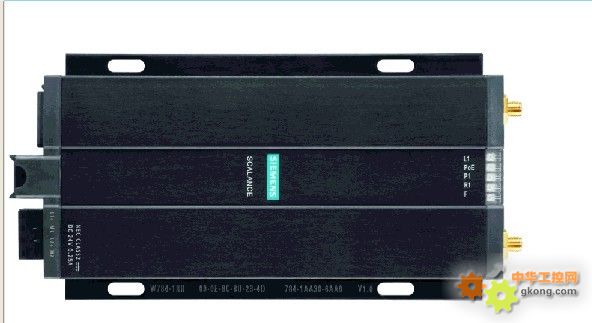

1.1 SCALANCE W784-1
SCALANCE W784-1 ½ÓÈëµãµÄ¹¦ÄÜÓ빤ҵÎÞÏß¾ÖÓòÍø LAN SCALANCE W788-1RR ½ÓÈëµãµÄ¹¦ÄÜÏàËÆ¡£Ëü¾ßÓÐÒ»¸öÎÞÏßÄ£¿é£¬²¢ÇÒÔÊÐí½« W784 µ¥ÔªÓÃÓÚÒÔÌ«Íø¿Í»§¶ËģʽÏ¡£
ΨһÀýÍ⣺W784-1 ²»¾ßÓÐ iPCF ÌØÐÔ (¿ìËÙÂþÓÎ)¡£
Óë SCALANCE W788-1RR ²»Í¬µÄ»úÐµÌØÐÔ£º
·         ÂÁ¹¹¼Ü
·         ¸÷ÀàÐÍÍⲿÌìÏߣ»ÌìÏß²»ÔÚ¹©»õ·¶Î§ÄÚ
·         IP30 ·À»¤µÈ¼¶£¬²»½á¶ (10 - 90%)
·         ²»¿É²ÉÓà 110-230V AC µÄ¹©µç
Óë SCALANCE W788-1RR ÏàͬµÄ»úÐµÌØÐÔ£º
·         ¼¯³ÉÎÞÏßÄ£¿é£­¿ÉÇл»µ½ 2.4 GHz (IEEE 802.11b/g) »ò 5 GHz (IEEE 802.11a/h)
·         RJ45 µç¿ÚÐÍÁ¬½ÓÆ÷
·         ËùÓа汾¿ÉʹÓà IEEE 802.3af ÒÔÌ«ÍøÏß¹©µçºÍÍⲿ 48V DC µçÔ´¡£
·         ¿ÉÑ¡ C-PLUG ºÍ PRESET-PLUG
·         ζȷ¶Î§£º-20°C µ½ +60°C
SCALANCE W784-1 ÊʺÏÓÚÇ½Ãæ°²×°£¬»òÕßʹÓÿÉÑ¡µÄ MS2 °²×°¹¤¾ß°²×°ÔÚ±ê×¼µ¼¹ì»ò S7-300 µ¼¹ìÉÏ¡£
×¢ÒâÊÂÏÈç¹ûʹÓà 35mm DIN °²×°£¬±ØÐë×ÐϸÔĶÁÓû§ÊÖ²áÖÐÓйØÀι̰²×°µÄ×¢ÒâÊÂÏî¡£
¶ÔÓÚ SCALANCE W788-1RR µ¥Ôª£¬ÒòΪÈÏÖ¤Ô­Òò£¬ÃÀ¹úÊг¡½«Ìṩ SCALANCE W784-1 µÄµ¥¶À°æ±¾²úÆ·¡£
1.2 SCALANCE W784-1RR
SCALANCE W784-1RR ½ÓÈëµãµÄ¹¦ÄÜÓë SCALANCE W788-1RR Ë«½ÓÈëµãµÄ¹¦ÄÜÏàËÆ£»ËüÓÐÒ»¸öÎÞÏßÄ£¿é¡£
SCALANCE W784-1RR µÄ»úеºÍµçÆøÌØÐÔÒÔ¼°¹©»õ·¶Î§Óë SCALANCE W784-1 Ïàͬ¡£
¶ÔÓÚ SCALANCE W788-1RR µ¥Ôª£¬ÒòΪÈÏÖ¤Ô­Òò£¬ÃÀ¹úÊг¡½«Ìṩ SCALANCE W784-1RR µÄµ¥¶À°æ±¾²úÆ·¡£
1.3 SCALANCE W744-1
SCALANCE W744-1 ÒÔÌ«Íø¿Í»§¶ËÄ£¿éµÄ¹¦ÄÜÓë SCALANCE W744-1PRO ÒÔÌ«Íø¿Í»§¶ËÄ£¿éµÄ¹¦ÄÜÏàËÆ£»ËüÓÐÒ»¸öÎÞÏßÄ£¿é¡£
SCALANCE W744-1 µÄ»úеºÍµçÆøÌØÐÔÒÔ¼°¹©»õ·¶Î§Óë SCALANCE W784-1 Ïàͬ¡£
¶ÔÓÚ SCALANCE W744-1PRO µ¥Ôª£¬ÒòΪÈÏÖ¤Ô­Òò£¬ÃÀ¹úÊг¡½«Ìṩ SCALANCE W744-1 µÄµ¥¶À°æ±¾²úÆ·¡£
1.4 SCALANCE W746-1
SCALANCE W746-1 ÒÔÌ«Íø¿Í»§¶ËÄ£¿éµÄ¹¦ÄÜÓë SCALANCE W746-1PRO ÒÔÌ«Íø¿Í»§¶ËÄ£¿éµÄ¹¦ÄÜÏàËÆ£»ËüÓÐÒ»¸öÎÞÏßÄ£¿é¡£
SCALANCE W746-1 µÄ»úеºÍµçÆøÌØÐÔÒÔ¼°¹©»õ·¶Î§Óë SCALANCE W784-1 Ïàͬ¡£
¶ÔÓÚ SCALANCE W746-1PRO µ¥Ôª£¬ÒòΪÈÏÖ¤Ô­Òò£¬ÃÀ¹úÊг¡½«Ìṩ SCALANCE W786-1 µÄµ¥¶À°æ±¾²úÆ·¡£
1.5 SCALANCE W747-1
SCALANCE W747-1 ÒÔÌ«Íø¿Í»§¶ËÄ£¿éµÄ¹¦ÄÜÓë  SCALANCE W747-1RR ÒÔÌ«Íø¿Í»§¶ËÄ£¿éµÄ¹¦ÄÜÏàËÆ£»ËüÓÐÒ»¸öÎÞÏßÄ£¿é¡£
SCALANCE W747-1 µÄ»úеºÍµçÆøÌØÐÔÒÔ¼°¹©»õ·¶Î§Óë SCALANCE W784-1 Ïàͬ¡£
¶ÔÓÚ SCALANCE W747-1RR µ¥Ôª£¬ÒòΪÈÏÖ¤Ô­Òò£¬ÃÀ¹úÊг¡½«Ìṩ SCALANCE W747-1 µÄµ¥¶À°æ±¾²úÆ·¡£
1.6 MS 2 °²×°¹¤¾ß°ü
ʹÓÿÉÑ¡µÄ MS 2 °²×°¹¤¾ß°ü£¬¿ÉÒÔ½« SCALANCE W-784 ½ÓÈëµãÒÔ¼° SCALANCE W744-1¡¢SCALANCE W746-1 ºÍ SCALANCE W747-1 ÒÔÌ«Íø¿Í»§¶ËÄ£¿é°²×°µ½ S7-300 µ¼¹ì»ò 35mm ±ê×¼ DIN °²×°µ¼¹ìÉÏ¡£
