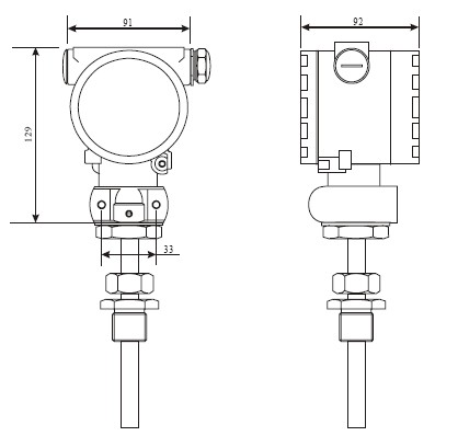

´«¸ÐÆ÷³¤¶È
L
¼ûÍâÐνṹͼ£¬ÌîÉϾßÌåµÄÊýÖµ£¬µ¥Î»mm
Àý£ºSWP£­CT80£­202R£­A£­03£­£¨100£©

ÍâÐγߴç
