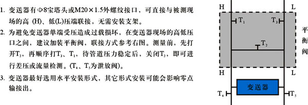

°²×°ÒªÇó

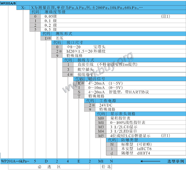

Ñ¡ÐÍ´úÂë

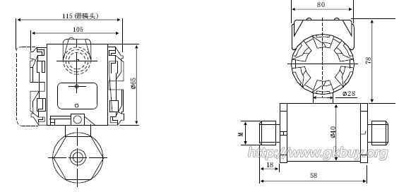

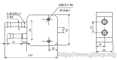

WP201A½á¹¹³ß´ç
WP201B½á¹¹³ß´ç
