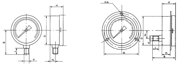

ÍâÐγߴ磨µ¥Î»£ºmm£©
ÐͺÅ
D
H H1 H2 B d2 d0 d L
YTN-60
¦Õ60
32 13 55 M14¡Á1.5 14
YTN-60ZT 22 0 65 4.5 76
YTN-60B 32 13 55
YTN-63B 22 0 65 4.5 76
YTN-100
¦Õ100 44 18 90 M20¡Á1.5 20
YTN-100ZT 27 30 90 5.5 118
YTN-100B 44 18 90
YTN-103B 27 30 90 5.5 118
YTN-150
¦Õ150 44 18 120 M20¡Á1.5 20
YTN-150ZT 27 55 95 5.5 165
YTN-150B 44 18 120
YTN-153B 27 55 95 5.5 165

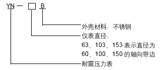

Ðͺűêʶ
¡¡×¢£ºÄÍÕðѹÁ¦±íYNºÍYTN×ÖĸÒâÒåÒ»Ö£¬ÊôÓÚͬһ²úÆ·¡£
