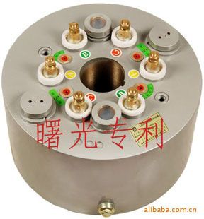

²úÆ·Ãû³Æ£º ÎÞË¢×Ô¿ØÕæ¿Õµç»úÈíÆð¶¯Æ÷
ÐÍ ºÅ£º WSZK
WSZKÎÞË¢Òº×è×Ô¿ØÕæ¿Õµç»úÈíÆð¶¯Æ÷
¸Å Êö
ÎÞË¢Òº×è×Ô¿ØÕæ¿Õµç»úÈíÆð¶¯Æ÷ÊÇÒ»ÖÖ¿Ë·þÁËÈÆÏßʽÒì²½µç¶¯»ú×°ÓÐ̼ˢ¡¢»¬»·ºÍ¸´Ôӵįð¶¯×°ÖõÈȱµã¡£¶ø±£ÁôÁËÈÆÏßµç»úµçÁ÷С£¬Æð¶¯×ª¾Ø´óµÈÓŵãµÄÆð¶¯É豸¡£ËüÄܸù¾Ýµç»úÐýתʱ²úÉúµÄÀëÐÄÁ¦£¬×Ô¶¯¿ØÖÆ´®Èëµç»úת×ÓÄڵĵç×è´óС£¬´ïµ½Ôö¼Óµç»úÆð¶¯×ª¾Ø¡¢¼õÉÙµç»úÆð¶¯µçÁ÷ºÍʵÏÖÈÆÏßʽÒì²½µç¶¯»úÎÞË¢ÔËÐеÄÄ¿µÄ£¬Ê¹µç¶¯»ú´¦ÓÚ×î¼ÑÆð¶¯×´Ì¬¡£Ëü¿ÉÒÔ´úÌæÈÆÏßʽµç¶¯»úµÄ»¬»·¡¢Ì¼Ë¢¼°ÆäËüÆð¶¯×°Öá£
²úÆ·Óŵã
WSZKÐÍÎÞË¢Òº×è×Ô¿ØÕæ¿Õµç»úÈíÆð¶¯Æ÷¿Ë·þÁ˶¨×Ó¿ØÖÆÊ½µç»úÈíÆð¶¯Æ÷µÄÆð¶¯×ª¾ØÓëÆð¶¯µçÁ÷µÄƽ·½³ÉÕý±È£¨µç»úÆð¶¯µçÁ÷´Ó7le½µµ½3.5le£¬Æð¶¯×ª¾Ø1.6MeÈÔΪ0.4Me£©ÕâһȱÏÝ¡£WZRÎÞË¢×Կصç»úÈíÆð¶¯Æ÷ÔÚ½µµÍµç»úÈíÆð¶¯µçÁ÷µÄͬʱ£¬Ôö¼Óµç»úÆð¶¯×ª¾Ø£¨µç»úÆð¶¯µçÁ÷´Ó7le½µµ½1.7leʱ£¬Æð¶¯×ª¾ØÈÔΪ1.6Me£©£¬²¢ÄÜÒÔ×î´óת¾Ø£¨2.5Me£©Æð¶¯µç»ú¡£ËüÓɵç×裨ˮµç×裩Æð¶¯×°Ö㨵ç×èÆð¶¯×°ÖÃÓëÆµÃô±ä×èÆ÷Æð¶¯×°ÖÃÏà±È£¬ÔÚͬµÈÆð¶¯µçÁ÷µÄÇé¿öÏ£¬Æð¶¯×ª¾ØÄÜÌá¸ß1.5±¶£©·¢Õ¹¶øÀ´£¬¾ßÓУº
1¡¢ÎÞË¢Òº×è×Կصç»úÈíÆð¶¯Æ÷³¹µ×¸ù³ýʹÓû¬»·¡¢Ì¼Ë¢Ê±ËùÔì³ÉµÄ¸÷ÖÖΣº¦¡£È¥µô´«Í³¡¢¸´Ôӵįð¶¯×°Ö㬲Ù×÷·½±ã¡£²¢¿É´ó´ó¼õÉÙάÐÞ·ÑÓá£
2¡¢½ÚÊ¡°²×°¿Õ¼äºÍ¶þ´Î»ØÂ·µçÀ£¬¼õÉÙÆð¶¯×°ÖõŦÂÊÏûºÄ£¬½ÚÔ¼Á˵çÄÜ¡£
WSZKÐÍÎÞË¢Òº×è×Ô¿ØÕæ¿Õµç»úÈíÆð¶¯²ÉÓÃÎÞË¢ÔËÐУ¬È¥µôÁË´«Í³¡¢·±Ëö¡¢¶à´¥µãÔª¼þ×é³ÉµÄÆð¶¯×°Ö㨼´È¥µôÁË»¬»·¡¢Ì¼Ë¢¡¢Ë¢ºÐ¡¢¶Ì·»·¼°Õû¸ö¶þ´Î»ØÂ·ÏµÍ³£©£¬ÆäÆð¶¯×°ÖõŦÂÊËðºÄ¼°µç»úµÄÆð¶¯Ê±¼ä±È¶¨×Ó¿ØÖÆÊ½µç»úÈíÆð¶¯Æ÷¼õÉÙ10±¶ÒÔÉÏ£¬µ«Æð¶¯Æ÷µÄ×ۺϼ۸ñ²»¼°ÆäËüÈíÆð¶¯Æ÷µÄ1/3¡£
ÊÊÓ÷¶Î§
µçÔ´µçѹ£ºÈýÏà50HZ380~10KV£»        Æð¶¯Æµ¶È£ºÃ¿Ð¡Ê±²»³¬¹ý12´Î£»
ÊÊÓõç»ú£ºÈýÏàÈÆÏßʽÒì²½µç¶¯»ú£»       »îÆÃ¸ß¶È£º²»³¬¹ý2000M£»
»·¾³Î¶ȣº×îµÍÆøÎÂ-20¡æ£¬×î¸ßÆøÎÂ+40¡æ£» ÎÞÒ×ȼ£¬Ò×±¬£¬ÎÞÑÏÖØ¸¯Ê´ÐÔÆøÌåµÄ³¡Ëù¡£
ÐÔÄÜÌØµã
WSZKÐÍÎÞË¢Òº×è×Ô¿ØÕæ¿Õµç»úÈíÆð¶¯µÄÆð¶¯µç×èÊÇÒºÌåµÄ£¬ËüµÄµçÆø¹¤×÷Ô­ÀíÈçͼËùʾ£¬Ö÷ÒªµçÆø»úеÐÔÄÜÀàËÆÓÚÈÆÏßʽÒì²½µç¶¯»úÈíÆð¶¯Æ÷£¬Ö»ÊÇ´®ÈëµÄµç×èÔÚÀëÐÄÁ¦×÷ÓÃÏ£¬Æä×èÖµÓëËÙ¶ÈµÄÆ½·½³É·´±ÈµØÁ¬Ðø¼õÉÙ£¬¾ßÓкãµçÁ÷¡¢ºãת¶ÌÆð¶¯µç»úµÄ¹¦ÄÜ¡£ËüµÄ×î´óÌØµãÊÇ£º¹«Ë¾¸ù¾ÝÓû§ÐèÒª£¬¿ÉÒÔʹÆð¶¯µçÁ÷ÔÚ0.8¡ª2.5le¡¢Æð¶¯×ª¾ØÔÚ0.8¡ª2.5MeÄÚÈÎÒâÉ趨£¬²¢Ê¹Æð¶¯µçÁ÷¡¢Æð¶¯×ª¾ØÔÚÆð¶¯¹ý³ÌÖнӽüºã¶¨¡£ÐèҪעÒâµÄÊÇ£¬µ±ÒºÃæµÍÓڹ涨Һλʱ£¬Ðè²¹³äµç½âÒº¡£Ëü·Ç³£ÊʺÏÓÚ¹¦ÂÊ´ó
130KWµÄ¸÷ÖÖÈÆÏßʽÒì²½µç¶¯»úµÄÆð¶¯¡£
ÔËÐÐÓëά»¤
1¡¢WSZKÐÍÎÞË¢Òº×è×Ô¿ØÕæ¿Õµç»úÈíÆð¶¯ÄÚµÄÔª¼þ³ýµç×èÔÚÆð¶¯Ê±»á·¢ÈÈʱ£¬ÆäËü¾ù²»»á·¢ÈÈ£¬±¾×°Öð´Ãâά»¤Éè¼Æ£¬Çë²»Òª×ÔÐн«Íâ¸Ç´ò¿ª£¬ÒÔÃâËð»µÆð¶¯Æ÷ÄÚµÄÔª¼þ¡£
2¡¢µ±WSZKÐÍÎÞË¢Òº×è×Ô¿ØÕæ¿Õµç»úÈíÆð¶¯ÒºÌåµÍÓڹ涨Һλʱ£¬Ó¦²¹³äµç½âÒºµ½¹æ¶¨µÄÒºÃæ¡£
Ë®Æø·ÖÀë·§ÊDZ£Ö¤µç»úÆð¶¯¹ý³ÌÖУ¬²»ÏòÍâÅçË®µÄÖØÒª²¿¼þ£¬ËüÔÚµç»úתËÙ´ïµ½É趨תËÙʱ£¬»á×Ô¶¯´ò¿ª£¬±£Ö¤Æð¶¯Æ÷ÄÚµÄѹÁ¦Óë´óÆøÑ¹Ò»Ö£¬Òò´Ë£¬ÇëÓû§²»Òª×ÔÐе÷Õû¡£
