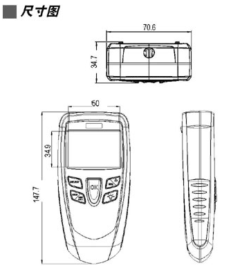

ÏÔʾ 2ÐÐLCDÏÔʾÆÁ,³ß´ç50x34.9mm

̽ͷ ¦µ13mm

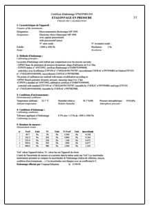

¹¤³§Ð£×¼Ö¤Êé
