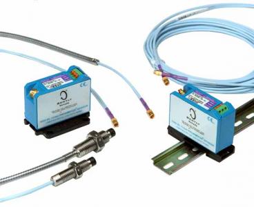

3300ϵÁд«¸ÐÆ÷ϵͳ£¬3300XLϵÁд«¸ÐÆ÷ϵͳ
3300 XL ϵÁд«¸ÐÆ÷
3300 XL 8 mm µçÎÐÁ÷´«¸ÐÆ÷ϵͳ
ÕâÖÖµçÎÐÁ÷´«¸ÐÆ÷ϵͳÌṩ×î¸ß 80Ãܶú (2 mm) µÄÏßÐÔ·¶Î§£¬Êä³öֵΪ 200 mV/Ãܶú¡£ËüÖ¼ÔÚ½â¾ö¾¶ÏòÕñ¶¯¡¢ÖáÏò£¨ÍÆÁ¦£©Î»Öá¢ËٶȺÍÏàλ (Keyphasor®) ²âÁ¿µÈ»úе¼à¿ØÓ¦ÓõÄÖØ´óÎÊÌ⣬²¢Âú×ãÃÀ¹úʯÓÍ×éÖ¯ (American Petroleum Institute) ±ê×¼ 670 µÚ 4 °æµÄÒªÇó¡£
3300 XL 11 mm µçÎÐÁ÷´«¸ÐÆ÷ϵͳ
ÕâÖÖµçÎÐÁ÷´«¸ÐÆ÷ϵͳÌṩ×î¸ß 160Ãܶú (4mm) µÄÏßÐÔ·¶Î§£¬Êä³öֵΪ 100 mV/Ãܶú¡£Ëü¾­¹ýÌØÊâÉè¼Æ£¬ÒÔ½â¾öÖáÏò£¨ÍÆÁ¦£©Î»ÒÆ¡¢ÆûÂÖ»úÐ±ÃæÊ½²îÕÍ¡¢Íù¸´Ê½Ñ¹Ëõ»ú¸Ëλ»ò¸Ë³Á½µ¡¢×ªËټƺÍÁãתËÙ£¬ÒÔ¼°Ïàλ (Keyphasor*) ²âÁ¿µÈ»úе¼à¿ØÓ¦ÓõÄÖØ´óÎÊÌâ¡£
3300 XL NSv™ µçÎÐÁ÷´«¸ÐÆ÷ϵͳ
ÕâÖÖ½Ó½üʽ̽Õëϵͳ½« 5mm ¶¥Ô²Ö±¾¶Óë¸ü¶ÌÏßÐÔ·¶Î§ 60Ãܶú (1.5 mm) ½áºÏÆðÀ´£¬ÒÔ½â¾öСĿ±êÇøÓò¡¢Ëõ¼õµÄ²âÊÔͼ»ò³Á¿×¼ä϶µÈÓ¦Óã¬Í¬Ê±Ô¼ÊøÊ¹ÓÃÎÒÃǵıê×¼ 5 mm / 8 mm ½Ó½üʽ̽ÕëµÄÏÞÖÆ¡£
3300 XL 25 mm µçÎÐÁ÷´«¸ÐÆ÷ϵͳ
ÕâÖÖϵͳÊʺϲâÁ¿ÖÐÐ͵½´óÐÍÕôÆøÎÐÂÖ·¢µç»úÉϵIJ»¾ùÓ¦ÅòÕÍ (DE) Çé¿ö£¬¸ÃÇé¿öµÄÆðÒòÊÇÎÐÂÖת×ӺͶ¨×Ó£¨Íâ¿Ç£©Ö®¼äµÄÔö³¤Âʲ»Ò»Ö¡£Ëü´ú±í×ÅÎÒÃÇÔø¾­ÔÚ DE ´«¸ÐÆ÷ϵͳÖÐÌṩµÄ×îÇ¿¾¢¼¼Êõ¡£
3300 XL 50mm ½Ó½üʽϵͳ
Bently Nevada™ 3300 XL 50mm ´«¸ÐÆ÷ϵͳÊÇÒ»Ì׷dz£Ç¿¾¢ºÍ¿É¿¿µÄ½Ó½üʽ̽Õëϵͳ¡£ËüÌṩ±ÈÔ­ÓÐϵͳ¸ü¸ßµÄÄͳ±ÊªÐÔÒÔ¼°¸ü¹ã·ºµÄζȷ¶Î§£¬²¢ÇÒ²»»áÓ°Ïì DE µÈ¿Á¿ÌÓ¦ÓÃËùÐèµÄÏßÐԺ;«È·¶È¡£
3300 ϵÁд«¸ÐÆ÷
3300 5 mm ½Ó½üʽ̽Õëϵͳ
ÔÚ¸÷ÖÖζȷ¶Î§ÄÚÌṩ¾«È·Îȶ¨µÄÐźÅÊä³ö£¬¾ß±¸×î¸ß 80 Ãܶú (2 mm) µÄÏßÐÔ·¶Î§£¬Êä³öֵΪ 200 mV/Ãܶú¡£ËüͬʱʤÈξ²Ì¬£¨Î»Ö㩺Ͷ¯Ì¬£¨Õñ¶¯£©²âÁ¿£¬²¢ÇÒÖ÷ÒªÓÃÓÚÕë¶ÔÒºÌ屡ĤÖá³Ð»úÆ÷µÄÕñ¶¯ºÍλÖòâÁ¿Ó¦Óã¬ÒÔ¼° Keyphasor® ²âÁ¿ºÍËÙ¶ÈÓ¦Óá£

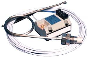

3300 16 mm ¸ßνӽüʽ´«¸ÐÆ÷ϵͳ
ÕâÖÖ½Ó½üʽ̽ÕëϵͳּÔÚ³ÐÊÜ×î¸ß 350¡ãC (662¡ãF) µÄ¸ßλ·¾³£¬ÀýÈçÄ³Ð©È¼ÆøºÍÕôÆûÎÐÂÖ»úÓ¦Óã¬ÄÇÀïµÄζȿÉÄܳ¬¹ýÎÒÃǵıê×¼½Ó½üʽ̽ÕëºÍµçÀÂËùÄܳÐÊܵÄÏÞÖµ¡£Ì½ÕëµÄÔ²¶¥Ö±¾¶Îª16mm£¬²¢ÇÒϵͳÌṩ×î¸ß 160Ãܶú (4 mm) µÄÏßÐÔ·¶Î§¡£
3300 REBAM® ´«¸ÐÆ÷ϵͳ
ÕâÖÖ¸ßÔöÒæ½Ó½üʽ̽ÕëϵͳּÔÚ²âÁ¿¹ö¶¯Ôª¼þÖá³ÐÍâ»·µÄ΢Ӣ´çÆ«²î¡£ËüÌṩÖá³ÐÌõ¼þµÄ¸üÖ±½Ó²âÁ¿£¬ÓëÍâ¿Ç°²×°µÄµØÕð´«¸ÐÆ÷£¨ÀýÈç¼ÓËټƣ©Ïà±ÈÃô¸Ð¶È¸ü¸ß£¬²¢ÇÒÐÅÔë±È¸üºÃ¡£ÏµÍ³ÌṩÁ½ÖÖÏßÐÔ·¶Î§Ñ¡Ï16Ãܶú£¨400 ΢Ã×£©£¬Êä³öΪ40V/mm£¬»ò 8Ãܶú£¨200 ΢Ã×£©£¬Êä³öΪ 80V/mm¡£
