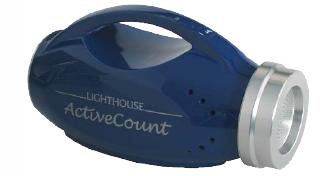

ActiveCount 60, 90C, 60 / 90C¸¡Óξú²ÉÑùÒÇ
¸¡Óξú²ÉÑùÒÇ
ÊÇΪÁË·ÀֹΣÏÕ»·¾³ÖеÄ΢ÉúÎïÎÛȾÉè¼ÆµÄ£¬±ÈÈç½à¾»ÊÒ¡¢Ê³Æ·¼Ó¹¤¹¤³§¡¢Ò½Ò©Éú²úÒÔ¼°Å¯Í¨¿Õµ÷ϵͳÖС£
ActiveCount¼ì²â¡¢Á¿»¯²¢×¼±¸Î¢ÉúÎï´æÔÚÓÚʵÑéÊҵIJÉÑù¿ÕÆøÖС£ActiveCountÓÐÖúÓÚʶ±ðÎÛȾԴºÍ¾ö¶¨ÐÞÕýÐÐΪµÄÓÐЧÐÔ¡£
ActiveCountµÄ²ÉÑù̽ͷΪ²»Ðâ¸Ö»òÕßÊǿɼÓѹ¼ÓÈÈÂÁÖÆ£¬60mm»òÕß90mmµÄÇí֬ƽ°å¡£ActiveCount 90C ºÍ 60-90/CÈÚºÏÁËÁ÷ËÙ²¹³¥ÒÔÈ·±£Á÷ËÙµÄ׼ȷÐÔ¡£
ActiveCount ´øÓпɳäµçÄøÇâµç³Ø±ãÓÚЯ´ø£¬ÇáÇɵÄÍâ¹ÛºÍÖØÁ¿Ê¹µÃÔÚÇøÓòÄÚ²ÉÑùʱ½ôÃܵÄÇåÀí¡£Ö±¹ÛµÄ¿ØÖÆÃæ°åÒÔ¼°ºìÍâÔ¶³Ì¿ØÖÆÆ÷ʹµÃÒÇÆ÷´Ó¸÷¸ö½Ç¶È¶¼ÇåÎú¿É¼û£¬²¢ÇÒActiveCount¸ü¶àÓ㬸ü±ãÓÚʹÓá£

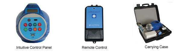

·ÒײÙ×÷¿ØÖÆÃæ°å
·ÇáÇÉÐÍÍâ¹Û
·µç³Ø³äµçÆ÷´ø³äÂúµçµÄָʾµÆ
·¿É³äµçÄøÇâµç³Ø
·ÉùÒô±¨¾¯
·¼âͷϵͳ
·99×éÑù±¾´æ´¢¼°ÏÔʾ
·ºìÍâÔ¶³Ì¿ØÖÆ

Ëæ»úÅä¼þ CD²Ù×÷Êֲᣬ°üÏ䣬±ÊͷʽÃð¾ú£¬µç³Ø³äµçÆ÷£¬Ô¶³ÌºìÍâ¿ØÖÆ£¬Ð£×¼Ö¤Ã÷
