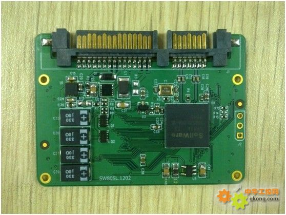

²úÆ·Ãû³Æ£º ¹Ì½Ý¹¤ÒµµçÄÔÓÃSSD
ÐÍ ºÅ£º ¹Ì½Ý SW80SL Slim Lite SATA
Æ· ÅÆ£º 2690
SW80SL Slim Lite SATA¹Ì̬´æ´¢Ä£¿é¹æ¸ñ
Ä£¿éϵÁÐ
¹Ì½ÝSW80LSS SLC
¹Ì½ÝSW80SLM MLC
½Ó¿ÚÀàÐÍ
SATA 1 or SATA 2
SATA 1 or SATA 2
ÈÝÁ¿
4, 8, 15, 32£¬64G
8, 16, 32, 64£¬128G
¹æ¸ñ
ÍâÐιæ¸ñ
JEDEC-MO297
Slim Lite SATA
JEDEC-MO297
Slim Lite SATA
Á¬½ÓÆ÷ÀàÐÍ
STD SATA 22PIN
STD SATA 22PIN
ÐÔÄÜ
˳Ðò¶Á£¨MAX£©
90M/s
80M/s
˳Ðòд£¨MAX£©
70M/s
30M/s
4KËæ»úдIO
1000 (³ÖÐø)
  500£¨³ÖÐø£©
4KËæ»úдIO
1500 (Í»·¢)
1000 (Í»·¢)
¿É¿¿ÐÔ
MTBF
>2,000,000 Сʱ
>2,000,000 Сʱ
ÔËÐгå»÷
1500G
1500G
ÔËÐÐÕð¶¯
15G
15G
дÈëÊÙÃü
´óÓÚ5Äê
´óÓÚ3Äê
¶ÁÈ¡ÊÙÃü
ÎÞÏÞÖÆ
ÎÞÏÞÖÆ
¹¦ºÄ
ÊäÈëµçѹ
5V
5V
¹¦ºÄ ¨C ÐÝÃß
30mA
30mA
¹¦ºÄ ¨C ³ÖÐø¶Á
70mA
70mA
¹¦ºÄ ¨C ³ÖÐøÐ´
110mA
160mA
³ß´ç¼°ÖØÁ¿
ÍâÐγߴç
54.00 x39.00 x4.00  mm
ÖØÁ¿
12g (Max.)
 12g (Max.)
ÔËÐл·¾³
ÔËÐÐζÈ
0 ¨C 70©bC
0 ¨C 70©bC
´¢´æÎ¶È
-25 ¨C 85©bC
-25 ¨C 85©bC
ÔëÒô
0dB
0dB
¹¦ÄÜÑ¡Ïî
ÔËÐÐζÈ
-25-85©bC£¬-40 ¨C 85©bC
-25-85©bC£¬-40 - 85©bC
Êý¾Ý°²È«
Çå¿Õ×Ô»Ù
Çå¿Õ×Ô»Ù
¼Ó¹Ì»·¾³
Èý·À´¦Àí£¬µ×²¿Ìî³ä
Èý·À´¦Àí£¬µ×²¿Ìî³ä
