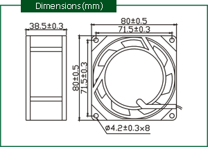

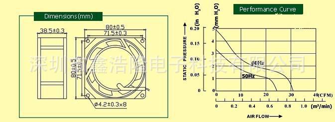

²úÆ·Ãû³Æ:AC8038É¢ÈÈ·çÉÈ
¹æ¸ñ³ß´ç£º80x80x38mm
Æ· ÅÆ:öκÆÂ¡
²ú µØ:China(Öйú)
ÐÍ ºÅ:HXA8038B22H
Öá³Ð½á¹¹:B:BALL (¹öÖéÖá³Ð)
µç ѹ:AC/220¡«240V AC
¹¦ ÂÊ:14/12(W)
Ƶ ÂÊ:50/60(Hz)
ת ËÙ:2450-2850(R/min)
·ç Á¿:0.68/0.88(M3/min)
Ôë Òô:32/37(dB-A)
ÖØ Á¿:330(g)
°ü ×°:É¢×°,ÎÞµ¥¶À°ü×°ºÐ,ÆÕͨӲֽÏä°ü×°50̨/1ÕûÏä;
¿ò ¼Ü:ºÚ¿¾ÆáÂÁºÏ½ðѹÖý·À¸¯¡¢·Àʪ½á¹¹£»
·ç Ò¶:×¢ËÜÒ»´Î³ÉÐÍ,PBT+30%²£Ïß+VO¼¶×èȼ¼Á£»
Öá ³Ð:²ÉÓø߾«¶È¡¢³¤ÊÙÃüµÍÔëÒô½ø¿Ú¹öÖéÖá³Ð£»
¾ø Ôµ:Æá°üÏß²ÉÓÃB¼¶¾øÔµ,ÄÍÎÂ120ÉãÊ϶È;
½ÓÏß·½Ê½:ÒýÏßʽ£¨¸ù¾Ý¿Í»§ÒªÇóÅäÏß £©
¾øÔµµç×è:500Õ×Å·ÒÔÉÏ;
Ä͵çѹ:©µçÁ÷0.5mA.Ä͵çѹ1500V/1·ÖÖÓ;
ÔËÐеçѹ:220V (µçѹ·¶Î§Îª:185V¡«245V)
·çÉÈÐýÏò:´ÓÉÈÒ¶·½Ïò¿´ÎªÄæÊ±Õ룻
ʹÓû·¾³Î¶È(¡æ):£20¡æ¡«75¡æ B:(¹öÖéÖá³Ð)
ÊÙÃü:¹¤×÷»·¾³Î¶È40¡æ B:(¹öÖéÖá³Ð) 60000(Сʱ)
ʹÓÃÊÙÃü³¤,¿ÉÁ¬Ðø24Сʱ³¤Ê±¼ä¹¤×÷¡£
ÌØÊâÐͺţº¿É¸ù¾Ý¿Í»§Í¼Ö½¿ªÄ£ÖÆÔìÉú²ú£¬ºÍÀ´ÑùÖÆÔìͶ²ú·Ç±ê׼Ʒ.±ê׼Ʒ¡£
