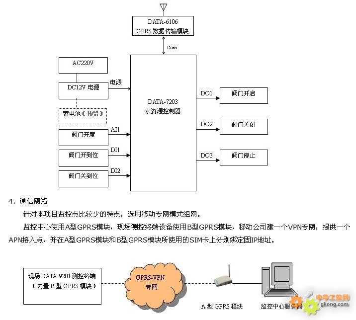

            (3) Ô¶³Ì¼à¿ØÉ豸£ºDATA-9201²â¿ØÖÕ¶Ë
            (4) ÏÖ³¡¿ØÖÆÉ豸£ºµç¶¯µ÷½Ú·§
      2.2¡¢ÏµÍ³ÍØÆËͼ
3¡¢Ô¶³Ì¼à¿ØÉ豸
      DATA-9201²â¿ØÖÕ¶ËÊǵ綯µ÷½Ú·§Ô¶³Ì¼à¿Øµ÷½ÚϵͳÖа²×°ÔÚ¼à²âÏÖ³¡µÄ¼à¿ØÉ豸£¬¿ÉʵÏֶԵ綯·§ÃŵÄÔ¶³Ì¿ØÖÆ¡£¼à²âÏÖ³¡µÄµç¶¯·§ÃÅÒªÇó¾ß±¸¿ª¶ÈÐźţ¨4~20mA£©Êä³öºÍ¿ªµ½Î»¡¢¹Øµ½Î»ÎÞÔ´¿ªµãÊä³ö¡£
      3.1  DATA-9201²â¿ØÖն˵ŦÄÜÌØµã
           (1) ²É¼¯µç¶¯·§ÃŵĿªµ½Î»¡¢¹Øµ½Î»×´Ì¬¡£
           (2) ²É¼¯µç¶¯·§ÃŵĿª¶È×´¿ö¡£
           (3) ¾ÍµØ¿ØÖƵ綯·§ÃŵĿªÆô¡¢¹Ø±ÕºÍÍ£Ö¹;¾ÍµØÏÔʾ·§ÃŵĿª¶ÈÖµ¡£
           (4) Ô¶³Ì¿ØÖƵ綯·§ÃŵĿªÆô¡¢¹Ø±ÕºÍÍ£Ö¹£»Ö§³ÖÔ¶³Ì¿ØÖÆ·§ÃŵĿª¶È£ºÉÏλ»úÈí¼þ¿ÉÉ趨·§ÃŵĿª¶È
      Öµ£¬¸ù¾ÝÉ趨µÄ¿ª¶ÈÖµ£¬¿É×Ô¶¯µ÷½Ú·§Ãŵ½Ô¤ÉèµÄλÖ㻾͵Ø/Ô¶³Ìģʽ¿ÉÇл»¡£
           (5) ´æ´¢¡¢ÏÔʾ¡¢²éѯ¼à²âÊý¾Ý¼°¹¤×÷²ÎÊý¡£
           (6) Ö§³Ö¾ÍµØ¡¢Ô¶³ÌÉ豸ά»¤¡£
           (7) ²â¿ØÖÕ¶ËÔ¤Áô´®¿ÚÁ÷Á¿¼Æ½Ó¿ÚºÍÆäËü·ûºÏ±ê×¼Êä³öµÄ±äËÍÆ÷½Ó¿Ú¡£
           (8) ²â¿ØÖÕ¶ËÏäÌ弰ת³éÈ«²¿²ÉÓò»Ðâ¸Ö²ÄÖÊ£¬ÒÔ·ÀË®·À³±·À¸¯Ê´¡£ÏÖ³¡²Ù×÷°´Å¥×°ÓÚÏäÄÚ¡£
           (9) ½ÓÊÕ¼à¿ØÖÐÐĵķ§ÃÅÔ¶³Ì¿ØÖÆÃüÁ±£ÕÏÎÞÏß¿ØÖÆ·§ÃŵĿª¶È£¬ÊµÏÖ·§Ãŵĵ÷½Ú×÷Óá£
           (10) ·Ç·¨´ò¿ª²â¿ØÖÕ¶ËÉ豸ʱ£¬¸æ¾¯£¬ÏÖ³¡É豸LEDµÆÁÁ+·äÃùÒô£¬±¨¾¯Êý¾ÝÉϱ¨¡£
           (11) ²â¿ØÖÕ¶ËÄÚÅäÐîµç³Ø£¬±£Ö¤ÊеçµôµçÇé¿öÏÂ24Сʱ¸ø²â¿ØÖÕ¶ËÌṩµçÔ´£¬Í¬Ê±½«Í£µçÐÅÏ¢Éϱ¨ÖÁ¼à¿Ø
      ÖÐÐÄ¡£
     3.2   ²â¿ØÖն˹¤×÷Ô­ÀíʾÒâͼ

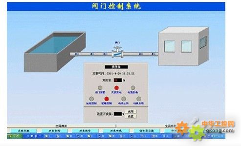

          µç¶¯µ÷½Ú·§Ô¶³Ì¼à¿Øµ÷½ÚϵͳÈí¼þ£ºDATA-WS02¼à¿ØÈí¼þ¡£
    5.3 µç¶¯µ÷½Ú·§Ô¶³Ì¼à¿Øµ÷½ÚϵͳÈí¼þ
          ²Ù×÷»­ÃæÓвÙ×÷·§ÃÅÊä³öָʾ¡¢ÏÖ³¡·§Î»Ö¸Ê¾¡¢¿ªµ½Î»¡¢¹Øµ½Î»Ö¸Ê¾¡£
