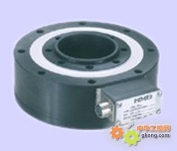

²úÆ·Ãû³Æ£º NMB³ÆÖØ´«¸ÐÆ÷
ÐÍ ºÅ£º C1W1M
Æ· ÅÆ£º 2689
C1W1M
ÌØµã£º
ͨ¿×ʽ£¬ÌرðÊÊÓÃÓÚ×¢ËÜ»ú¡£
²ÎÊýÃèÊö£º
Á¿³Ì
58.84KN{6tf}¡«490.3KN{50tf}
Êä³ö×迹
420¦¸¡À40¦¸
°²È«ÔغÉ
150%R.C.
ÊäÈë×迹
350¦¸¡À3¦¸
½çÏÞÔØºÉ
150%R.C.
¾øÔµ×迹
2000M¦¸
µçÁ÷Êä³ö
4mA¡«20mA£¨3ÏßÖÆ£©
¹¤×÷ζȷ¶Î§
-10¡æ~70¡æ
·ÇÏßÐÔ
0.6%R.O.
ζȲ¹³¥·¶Î§
0¡æ~60¡æ
ÖͺóÐÔ
0.6%R.O.
ÁãµãÎÂÆ¯
0.15%R.O./ 10¡æ
ÖØ¸´ÐÔ
0.2%R.O.
Âú³ÌÎÂÆ¯
0.15%LOAD/10¡æ
Èä±ä
0.025%R.O./20min
µ¼Ïß³¤¶È
5m
¼¤Àøµçѹ
DC 24V
·À»¤µÈ¼¶
IP64
¼¤Àø·¶Î§
21.6V~26.4V
²ÄÁÏ
ºÏ½ð¸Ö
ʹÓÃÊÙÃü
106´Î
