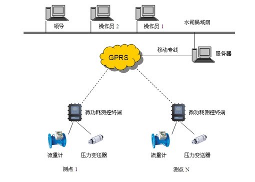

    ×ÔÀ´Ë®¹ÜÍøÔÚÏß¼à²â£¬¹ÜµÀѹÁ¦¼à¿ØÏµÍ³ÊÊÓÃÓÚ¹©Ë®ÆóÒµÔ¶³Ì¼à²â¹©Ë®¹ÜÍø£¬¹¤×÷ÈËÔ±¿ÉÒÔÔÚˮ˾µ÷¶ÈÖÐÐÄÔ¶³Ì¼à²âÈ«Êй©Ë®¹ÜÍøµÄѹÁ¦¼°Á÷Á¿Çé¿ö¡£¿ÆÑ§Ö¸»Ó¸÷Ë®³§ÆôÍ£¹©Ë®É豸£¬±£ÕϹ©Ë®Ñ¹Á¦Æ½ºâ¡¢Á÷Á¿Îȶ¨£»¼°Ê±·¢ÏÖºÍÔ¤²â±¬¹Üʹʵķ¢Éú¡£
---ϵͳ×é³É---
×ÔÀ´Ë®¹ÜÍøÔÚÏß¼à²â£¬¹ÜµÀѹÁ¦¼à¿ØÏµÍ³ÊÇˮ˾¹©Ë®µ÷¶È¹ÜÀíϵͳµÄÒ»¸ö×Óϵͳ£¬Ö÷ÒªÓÉˮ˾µ÷¶ÈÖÐÐÄ¡¢Í¨ÐÅÆ½Ì¨¡¢²â¿ØÖÕ¶Ë¡¢Ñ¹Á¦±äËÍÆ÷ºÍÁ÷Á¿ÒDZí×é³É¡£
---ͨÐÅÆ½Ì¨---
ˮ˾µ÷¶ÈÖÐÐÄ¡¢¸÷Ö°Äܲ¿ÃÅÖ®¼äÊý¾ÝͨÐÅÔÚ¾ÖÓòÍøÄÚÍê³É£»¹ÜÍø²âµãÓëˮ˾µ÷¶ÈÖÐÐÄÖ®¼ä²ÉÓÃGPRSÎÞÏßͨÐÅ¡£
