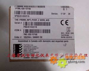

²úÆ·Ãû³Æ£º Siemens³¬Éù²¨ÒºÎ»±äËÍÆ÷7ML1201
ÐÍ ºÅ£º 7ML1201-0EK00
Æ· ÅÆ£º 1
µÂ¹úÎ÷ÃÅ×ÓThe Probe³¬Éù²¨ÒºÎ»¼Æ£¨ÒºÎ»±äËÍÆ÷£©7ML1201-1EE00

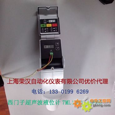

7ML1201³¬Éù²¨ÒºÎ»±äËÍÆ÷ÊÇÎ÷ÃÅ×Ó¹«Ë¾Ò»¿î¸ßÐԼ۱ȵÄҺλ²âÁ¿ÒÇ±í£¬7ML1201£¨The Probe£©Ò»Ì廯³¬Éù²¨ÒºÎ»¼Æ½«´«¸ÐÆ÷ºÍµç×Ó±äË͵¥Ôª·â×°ÓÚÒ»Ìå£¬ÌØ±ðÊʺÏÓÚ²âÁ¿¸÷ÖÖ¶ÌÁ¿³ÌµÄ³¨¿ª»òÃܱÕÈÝÆ÷ÖеÄÒºÌå¼°½¬Ìå¡£7ML1201Ò»Ì廯 ³¬Éù²¨ÒºÎ»±äËÍÆ÷µÄ´«¸ÐÆ÷²ÉÓÃETFE»òPVDF¾ÛºÏ²ÄÁÏ£¬¿É¹ã·ºµØÓ¦ÓÃÓÚ¸÷ÖÖ»¯Ñ§´¢¹Þ£¬Â˳أ¬Äà²Û£¬ÒºÌå´¢¹ÞµÈ¹¤ÒµÏÖ³¡¡£
7ML1201£¨The Probe£©³¬Éù²¨ÒºÎ»±äËÍÆ÷²úÆ·ÌØµã
Ò×ÓÚ°²×°±à³ÌºÍά»¤
¾«È·ÇÒ¿É¿¿
´«¸ÐÆ÷²ÉÓÃKynar-Flex»òTefzel²ÄÖÊ
¿ÉÑ¡ÎÀÉúÐÍ
רÀûµÄÉùÖÇÄܻز¨´¦Àí¼¼Êõ
ÄÚÖÃζȲ¹³¥
²âÁ¿·¶Î§0.25¡«11m
¾«¶È0.25%
·Ö±æÂÊ3mm
»·¾³Î¶È-40¡«60¡æ
±¾Öʰ²È«ÐÍ¿ÉÑ¡
Èý¡¢¼¼Êõ¹æ¸ñ£º
ÈýÏßÖÆ ¶þÏßÖÆ
²Ù×÷ģʽ
²âÁ¿Ô­Àí ³¬Éù²¨ÒºÎ»²âÁ¿
ÊäÈë
²âÁ¿·¶Î§ 0.25-5M 0.25-5M
Êä³ö
mA 4-20mA 4-20mA
²âÁ¿·¶Î§ Õý±È»ò·´±È Õý±È»ò·´±È
×î´ó¸ºÔØ 750 24VDCʱ750¦¸ 600 24VDCʱ»ØÂ·¸ºÔØ600¦¸
¼ÌµçÆ÷ ÓÃÓÚҺ뱨¾¯ºÍʧЧ±¨¾¯ ¡Á
µçÔ´
µçÔ´µçѹ 18-30VDC£¬×î´ó0.2A 12-28VDC£¬×î´óÀËÓ¿0.1A
×î´óµçÄÜÏûºÄ 5W
£¨200Ma,24VDC£© 0.75W
(25Ma,24VDC)
±ê×¼ºÍÈÏÖ¤ CE£»CSA£¬FM3A CE£¬CSA£¬FM3A
¾«¶È£º
²âÁ¿Îó²î£º ²âÁ¿·¶Î§µÄ0.25%£¨¿ÕÆøÖУ©
·Ö±æÂÊ£º 3mm
ζȲ¹³¥£º ÄÚÖÃ
»Ø²¨´¦Àí£º ÉùÖÇÄÜ
¶î¶¨¹¤×÷Ìõ¼þ£º
²¨Êø½Ç£º 12¶È
»·¾³Î¶ȣº
±ê×¼ -40~60¡æ
 ½ðÊô°²×° -20~60¡æ
×î´ó¾²Ì¬¹¤×÷ѹÁ¦£º Õý³£´óÆøÑ¹
·À»¤µÈ¼¶£º IP65
ÖØÁ¿£º²»´ø·¨À¼ÊÊÅäÆ÷ 1.5Kg
 ´ø·¨À¼ÊÊÅäÆ÷ 1.7Kg
µç×ÓÍâ¿Ç²ÄÖÊ£ºPVC£¬´«¸ÐÆ÷²ÄÖÊ£ºETFE»òPVDF¾ÛºÏÎï
