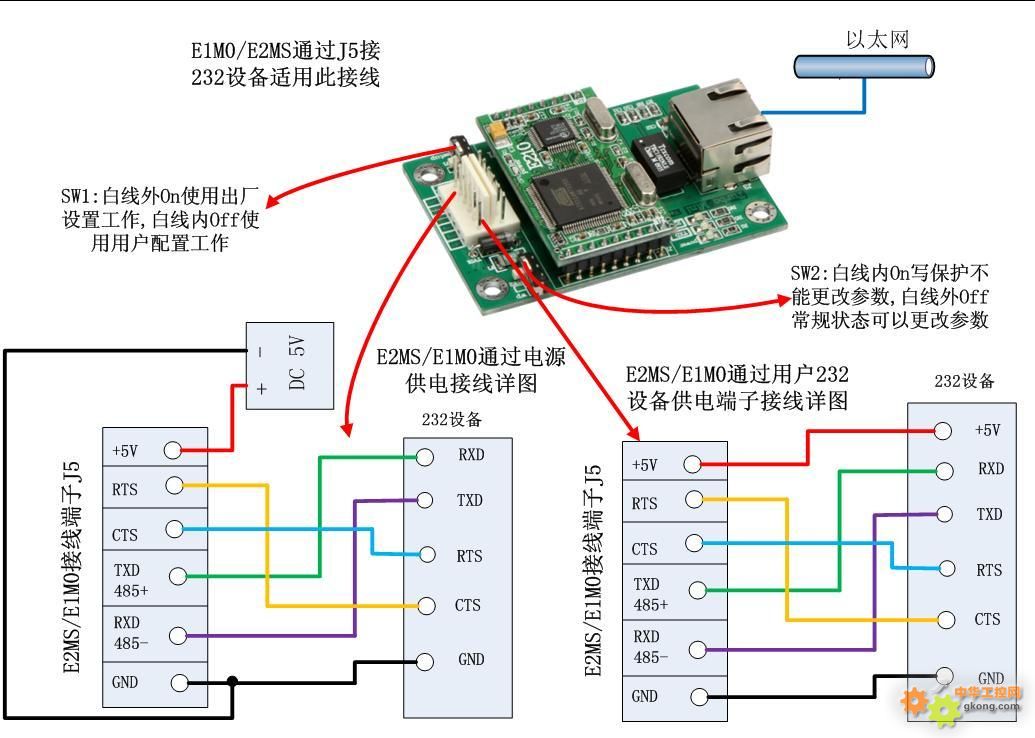

C2000 E1M0ÊǾßÓиßÐÔ¼Û±ÈÇÒÎȶ¨¿É¿¿µÄ´®¿ÚÉ豸ǶÈëʽÁªÍøÄ£¿é£¬ËüÌṩRS-232ºÍTTL´®¿Úµ½TCP/IPÍøÂçºÍTCP/IPÍøÂçµ½RS-232ºÍTTL´®¿ÚÊý¾Ý͸Ã÷´«Ê䣬Ëü¿ÉÒÔʹÉ豸Á¢¼´¾ß±¸ÁªÈëTCP/IPÍøÂçµÄ¹¦ÄÜ¡£
C2000 E1M0ÏòÉÏÌṩ10MÒÔÌ«Íø½Ó¿Ú£¬ÏòÏÂÌṩ1¸ö±ê×¼RS-232ºÍTTL´®Ðпڣ¬Í¨Ñ¶²ÎÊý¿Éͨ¹ý¶àÖÖÉèÖ÷½Ê½ÉèÖá£C2000 E1M0¿É¹ã·ºÓ¦ÓÃÓÚPLC¿ØÖÆÓë¹ÜÀí¡¢ÃŽûÒ½ÁÆ¡¢Â¥Óî¿ØÖÆ¡¢¹¤Òµ×Ô¶¯»¯¡¢²âÁ¿ÒÇ±í¼°»·¾³¶¯Á¦¼à¿ØÏµÍ³¡¢ÐÅÏ¢¼Òµç¡¢LEDÐÅÏ¢ÏÔʾÉ豸ºÍCNC¹ÜÀíµÈ¡£

a) ±¾²úÆ·ÓÐÒÔÏÂÈýÖÖ¹¤×÷ģʽ£º
1£®×÷ΪTCP·þÎñÆ÷£¬×ª»»Æ÷ÉϵçºóÔÚÖ¸¶¨µÄTCP ¶Ë¿ÚµÈ´ýÊý¾Ý·þÎñÆ÷µÄÁ¬½ÓÇëÇó£¬Êý¾Ý·þÎñÆ÷ÔÚÐèÒªÓëת»»Æ÷ͨѶµÄʱºò£¬Ïòת»»Æ÷µÄ¼àÌý¶Ë¿ÚÇëÇó½¨Á¢TCP Á¬½Ó£¬Á¬½Ó½¨Á¢ºó£¬Êý¾Ý·þÎñÆ÷¿ÉÒÔËæÊ±Ïòת»»Æ÷·¢ËÍÊý¾Ý£¬×ª»»Æ÷Ò²¿ÉÒÔËæÊ±½«Êý¾Ý·¢Ë͵½Êý¾Ý·þÎñÆ÷£¬ÔÚÍê³ÉÖ¸¶¨µÄͨѶºó£¬Êý¾Ý·þÎñÆ÷¿ÉÒÔÖ÷¶¯ÒªÇó¶Ï¿ªÁ¬½Ó£¬·ñÔòÁ¬½ÓÒ»Ö±±£³Ö¡£
2£®×÷ΪTCP¿Í»§¶Ë£¬×ª»»Æ÷Éϵçʱ»áÖ÷¶¯Ïò·þÎñÆ÷ÇëÇóÁ¬½Ó£¬Ö±µ½TCPÁ¬½Ó½¨Á¢ÎªÖ¹£¬²¢ÇÒÁ¬½ÓÒ»µ©½¨Á¢½«Ò»Ö±±£³Ö£¬Á¬½Ó½¨Á¢ºó£¬Êý¾Ý·þÎñÆ÷¿ÉÒÔËæÊ±Ïòת»»Æ÷·¢ËÍÊý¾Ý£¬×ª»»Æ÷Ò²¿ÉÒÔËæÊ±½«Êý¾Ý·¢Ë͵½Êý¾Ý·þÎñÆ÷¡£
3£®UDP·½Ê½£¬µ±C2000 ¹¤×÷ÔÚ¡°UDP¡±Ä£Ê½Ê±£¬ËüÄܽÓÊÕËùÓеÄIPµØÖ·ºÍ¶Ë¿Ú·¢¹ýÀ´µÄÊý¾Ý£¬µ«Ö»½«·µ»ØµÄÊý¾Ý·¢Ë͸øÖ¸¶¨µÄIPµØÖ·ºÍ¶Ë¿Ú¡£
b) Ó¦ÓÃÈí¼þ¿ÉʹÓÃÈýÖÖ·½Ê½Óëת»»Æ÷ͨѶ£º
1£®Í¨¹ý±¾¹«Ë¾¿ª·¢µÄÐéÄâ´®¿Ú¹ÜÀí³ÌÐò£¬½«ÍøÂçÊý¾ÝÖØ¶¨Ïòµ½ÐéÄâ´®¿Ú£¬È»ºó´ÓÐéÄâ´®¿Ú¶ÁÈ¡Êý¾Ý¡£
2£®Óñ¾¹«Ë¾¿ª·¢µÄ¿Ø¼þEDSockServer.ocx(»ò¶¯Ì¬¿âEDSockServer.dll)¡£
3£®Ê¹ÓÃSocket½øÐÐͨѶ¡£

´®¿Ú
TTL/232 TXD£¬RXD£¬RTS£¬CTS£¬GND
´®¿ÚͨÐŲÎÊý
ЧÑé None , Even , Odd , MARK , SPACE
Êý¾Ýλ 8
ֹͣλ 1¡¢2
Á÷Á¿¿ØÖÆ RTS/CTS£¬XON/XOFF£¬None
ËÙÂÊ 1200bps~115200bps
Èí¼þÌØµã
ЭÒé ARP£¬IP£¬ICMP£¬TCP£¬UDP£¬DHCP£¬HTTP
²Ù×÷ģʽ TCP Server¡¢TCP Client¡¢UDP¡¢ÐéÄâ´®¿Ú¡¢µã¶ÔµãÁ¬½Ó
ÉèÖà C2000ÉèÖóÌÐò¡¢Webä¯ÀÀÆ÷¡¢ÉèÖö¯Ì¬¿â¡¢´®¿ÚÉèÖ㨿ÉÑ¡£©
ÌṩÈí¼þ ÐéÄâ´®¿ÚÈí¼þ¡¢C2000ÉèÖóÌÐò¡¢´®¿Úµ÷ÊÔ¹¤¾ß¡¢ÍøÂçÉèÖóÌÐò¡¢EDSockServer.OCX¡¢EDSockServer.DLL¡¢ÉèÖö¯Ì¬¿âÒÔ¼°VB¡¢VC¡¢BC¡¢DelphiµÄʾÀý´úÂë
Çý¶¯Ö§³Ö Windows 98/ME/2000/XP/2003/Vista/7 32λ
µçÔ´ÐèÇó
µçÔ´¹æ¸ñ 5VDC£¬¡À5%
µçÁ÷ ×î´óµçÁ÷СÓÚ100mA
¹¤×÷»·¾³
²Ù×÷ζȡ¢Êª¶È 0¡æ~70¡æ£¬5~95%RH²»Äý¶
´æ´¢Î¶ȡ¢Êª¶È -60¡æ~125¡æ£¬5~95%RH²»Äý¶
³ß´ç
¶¨Î»¿×¼ä¾à 58.42*34.036 mm
¶¨Î»¿×Ö±¾¶ 3.5 mm
