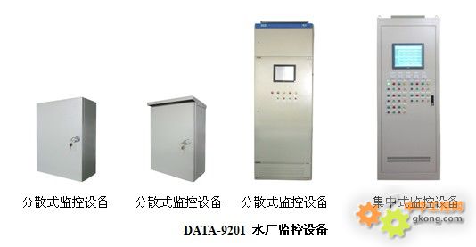

¸ÃÉ豸ÊÊÓÃÓÚ¹©Ë®ÆóÒµÔ¶³Ì¼à²âË®³§µÄ½ø³öË®Á÷Á¿¡¢Ë®³ØË®Î»¡¢³ö³§Ñ¹Á¦¡¢Ë®ÖÊÒÔ¼°¼Óѹ±Ã×é¡¢ÅäµçÉ豸¡¢Ïû¶¾ÉèÊ©µÄÔËÐÐ״̬µÈ¡£¸ÃÉ豸ͬʱ¿ÉÊÖ¶¯¿ØÖÆ¡¢×Ô¶¯¿ØÖÆ¡¢Ô¶³Ì¿ØÖƼÓѹ±Ã×éµÄÆôÍ££¬¿É¶ÔË®³§ÄÚÖØÒª²¿Î»ÊµÊ©ÊÓÆµ¼à¿Ø¡£
²úÆ·Ðͺţº
DATA-9201 Ë®³§¼à¿ØÉ豸
²úƷͼƬ£º
²úÆ·ÌØµã£º
1¡¢¹¦ÄÜÇ¿´ó£º¿ÉͬʱʵÏÖÊý¾Ý¼à²â¡¢Âß¼­¿ØÖƺÍÊÓÆµ¼à¿Ø¹¦ÄÜ¡£
2¡¢ÅäÖÃÁé»î£ºµ±Ë®³§ÄÚÉèÊ©¼¯ÖС¢²¼Ïß·½±ãʱ£¬ ¿ÉÑ¡Óü¯ÖÐʽ¼à¿ØÉ豸£»µ±Ë®³§ÄÚÉèÊ©·ÖÉ¢¡¢²»Òײ¼Ïßʱ£¬¿ÉÑ¡Ó÷Öɢʽ¼à¿ØÉ豸¡£
3¡¢¼æÈÝÐÔÇ¿£º¼æÈݸ÷ÖÖÀàÐͱäËÍÆ÷¡¢ÒÇ±í¡¢Ë®±Ã¡¢·§ÃŵÈÉ豸¡£
4¡¢Î¬»¤·½±ã£º¿ÉÔ¶³ÌÉèÖù¤×÷²ÎÊý¡¢Éý¼¶É豸³ÌÐò¡£
5¡¢½ÓÈëÁé»î£º¼à¿ØÊý¾Ý¿É½ÓÈëÌÆÉ½Æ½Éý¹«Ë¾ÅäÌ×µÄ¼à¿ØÈí¼þ£¬Ò²¿É½ÓÈë×é̬Èí¼þ»òÓû§×ÔÐпª·¢µÄ¼à¿ØÈí¼þ¡£
²úÆ·¹¦ÄÜ£º
²É¼¯¹¦ÄÜ£º²É¼¯½ø³§Á÷Á¿¡¢ÐîË®³ØË®Î»¡¢ÇåË®³ØË®Î»ÒÔ¼°³ö³§Ñ¹Á¦¡¢Á÷Á¿ºÍË®ÖÊ£»²É¼¯¼Óѹ±Ã×éµÄÆôͣ״̬¡¢ÔËÐÐʱ¼äºÍµçѹ¡¢µçÁ÷¡¢µçÄÜ£»²É¼¯°²·À±¨¾¯×´Ì¬¡¢ÅäµçÉ豸״̬£»¹âÏËͨÐÅʱ£¬Ö§³Ö²É¼¯ÊµÊ±ÊÓÆµ¡£
ͨÐŹ¦ÄÜ£º¿É²ÉÓùâÏË¡¢ÒÔÌ«Íø¡¢RS485×ÜÏß¡¢GPRSµÈͨÐÅ·½Ê½¡£
´æ´¢¹¦ÄÜ£ºÑ­»·´æ´¢ÏÖ³¡¼à¿ØÐÅÏ¢£¬ÒÔ±¸²éѯ¡£
ÈË»ú½çÃæ£º¹¤ÒµÆ½°åµçÄÔʵʱÏÔʾ¼à²âÊý¾ÝºÍÏà¹ØÉ豸ÔËÐÐ״̬£¬Ö§³Ö´¥Ãþ²Ù×÷¡£
¿ØÖƹ¦ÄÜ£ºÖ§³ÖÊÖ¶¯¿ØÖÆ¡¢×Ô¶¯¿ØÖÆ¡¢Ô¶³Ì¿ØÖƼÓѹ±Ã×éµÄÆôÍ££»¿ØÖÆÄ£Ê½¿ÉÇл»¡£
±¨¾¯¹¦ÄÜ£ºµçÁ÷¹ý´ó¡¢Ë®Î»¹ýµÍ¡¢Ñ¹Á¦¹ý¸ß¡¢¿ØÖƹñ±£»¤¡¢Åäµç¹ÊÕÏ¡¢ÏÐÈ˽øÈëµÈ×´¿ö·¢Éúʱ£¬Á¢¼´Éϱ¨¸æ¾¯ÐÅÏ¢¡£
