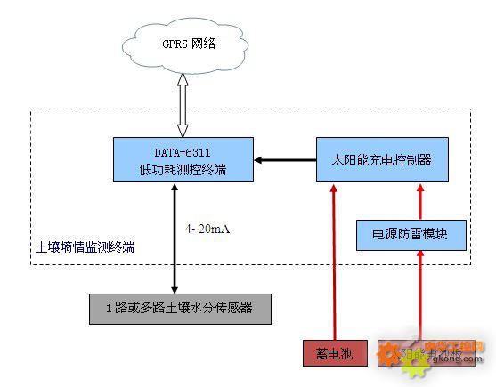

¼à²âÖÕ¶ËÄڵĺËÐIJúÆ·Ñ¡ÓÃDATA-6311Ð͵͹¦ºÄ²â¿ØÖÕ¶Ë¡£¸Ã²úÆ·¼¯Êý¾Ý²É¼¯¡¢ÏÔʾ¡¢´«Êä¡¢´æ´¢¹¦ÄÜÓÚÒ»Ì壬²ÉÓõ͹¦ºÄÉè¼Æ£¬ÌرðÊÊÓÃÓÚÌ«ÑôÄܹ©µçµÄ¼à²âÏÖ³¡£¬¿É´ó´ó¼õÉÙÌ«ÑôÄܹ©µç³É±¾²¢½µµÍÊ©¹¤ÄѶȡ£
²úÆ·ÌØµã
1¡¢Êý¾Ý²É¼¯¡¢´«ÊäÒ»Ì廯Éè¼Æ¡£
2¡¢GPRSʵʱÔÚÏß¹¦ºÄµÍ£¬ÔÚÏ߯½¾ùµçÁ÷≤10mA¡£

¡ô ¹¤×÷Ô­ÀíʾÒâͼ£º
