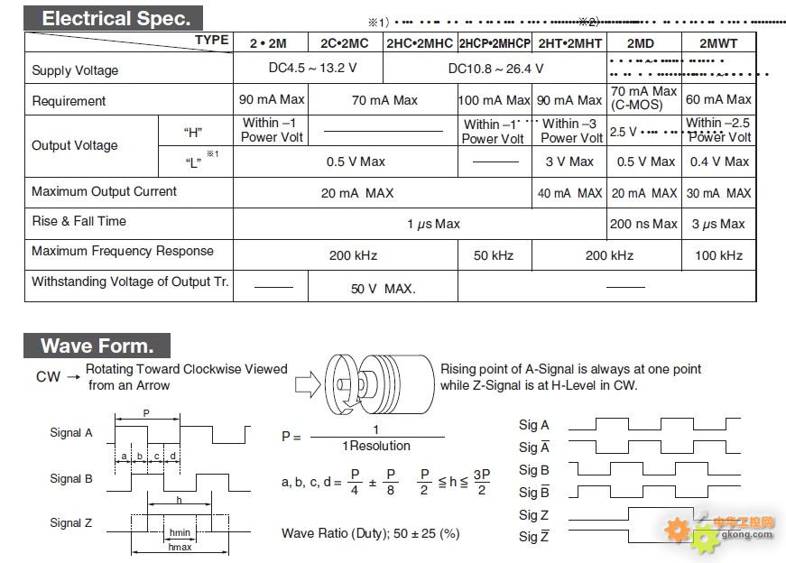

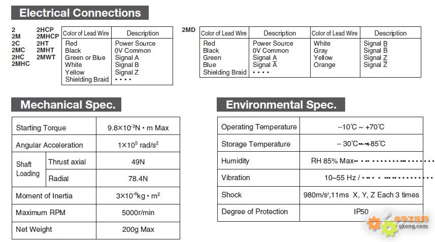

ÐÍ ºÅ£º NOC-S5000
ÈÕ±¾NEMICON±àÂëÆ÷NOC-S²úÆ·ÐÔÄÜ
1¡¢ÍâÐͳߴ磺§¶50*35
2¡¢Öá¾¶£º§¶8, §¶10, §¶9.525 DÐÍÇпÚ
3¡¢Âö³åÊý£º30p/r-5000p/r
4¡¢µçѹ:5-12v»ò12-24v

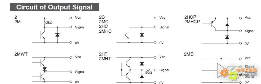

5¡¢Êä³öÐźÅ:AÏà.BÏà.ZÏà
6¡¢Êä³öÐÎʽ£º¿ª·Å¼¯µç¼«Êä³ö¡¢µçѹÊä³ö
7¡¢×î¸ßÏìӦƵÂÊ£º200kHz
8¡¢×î¸ßתËÙ£º6000r/min
9¡¢±£»¤µÈ¼¶£ºIP50,
10¡¢Ê¹ÓÃζȣº-10¡æ+70¡æ
ÖØµãÍÆ¼öÐͺţº
NOC2-S500-2HC
NOC2-S1000-2HC
NOC-S5000-2MHC
NOC-S5000-2MHT
NOC-S5000-2MD
