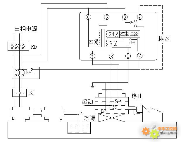

ÒDZíͨ¹ýµç¼«½Ó´¥µ¼µçÒºÌ壬Ôڵ缫¼äÊ©¼Ó8V»ò24V½»Á÷µçѹ£¬µ±µç¼«´Ó¶Ï¿ª×´Ì¬±äΪ´®½ÓÒºÌåµç×èʱ£¬Ðγɵ¼µçͨ·´Ó¶ø²úÉúµçÐźţ¬¾­µçÆ÷¿ØÖÆÏß·ʹÒDZíÄڼ̵çÆ÷¹¤×÷£¬Êä³ö¿ª¹ØÐźŶÔҺλ¿ØÖƱ¨¾¯¡£
ÒDZíµçÆø¿ØÖƼûʾÒâͼһ£»ÒDZí¢ß£¬¢à£¬¢ÙÈý¸ö¶Ë×Ó·Ö±ðÓë´«¸ÐÆ÷E1,E2,E3Èý¸ùµç¼«ÏàÁ¬£¬ÒDZíÊä³ö¿ØÖƵĢڣ¬¢Û£¬¢ÜÖеÄÒ»¸ö¶Ë×ÓÓëµç»úµç´Å¿ØÖÆ¿ª¹ØÈÆ×é¶Ë×ÓÏà´®Áª£¬×é³É×Ô¿ØÏµÍ³¡£
ÒDZíÓÉ¿ØÖÆÆ÷ºÍ´«¸ÐÆ÷Á½²¿·Ý×é³É¡£
¿ØÖÆÆ÷½á¹¹ÍâÐγߴç¼û¸½Í¼¡£
¿ØÖÆÆ÷ÓɵçÔ´±äѹÆ÷¡¢Ö±Á÷¼ÌµçÆ÷¡¢Ö¸Ê¾µÆµÈµçÆøÔª¼þ×é³É¡£
´«¸ÐÆ÷ÆäÍâÐγߴç¼û¸½Í¼¡£´«¸ÐÆ÷Óɵ缫±£³ÖÆ÷ºÍµç¼«×é³É¡£
µç¼«±£³ÖÆ÷ÓÐÒ»°ãÓÃPSÐÍ£¬¸ßÎÂÓÃBFÐÍ¡¢Ä͸ßθßѹBSÐÍ¡£µç¼«¾ù²ÉÓÃΦ4ÓÅÖʲ»Ðâ¸Ö¡£Æä³ß´ç³¤¶È¿É°´Êµ¼ÊÐèÒª¶ø¶¨¡£
