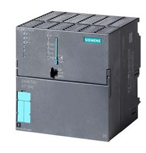

ÐÍ ºÅ£º 6ES7 953-8LJ30-0AA0
Æ· ÅÆ£º 1
SIMATICS7£¬Î¢ÐÍ´æ´¢¿¨P.S7300/C7/ET20 0£¬ 3.3VNFLASH£¬512KB
±¾Àý¹¦ÄܽéÉÜ
ÓÉÓÚCPU µÄÊý¾ÝÈÝÁ¿ÓÐÏÞ£¬¿ÉÒÔ°ÑCPU µÄÊý¾Ý´æ·ÅÓÚMMC ÖУ¬²¢¶ÔÆäÖÐÊý¾Ý½øÐжÁд²Ù×÷£¬µäÐÍÓ¦ÓÃΪÊý¾ÝÅä·½¹¦ÄÜ£¬ÕâЩÊý¾Ý¿ÉÒÔÖ»´æÓÚ MMC £¨Load Memory) ÖУ¬¶ø²»Õ¼CPU µÄÈÝÁ¿£¨Working Memory)£¬µ±ÐèҪʹÓÃʱ¿Éͨ¹ý³ÌÐò¶Áд¡£×¢Òâ MMC µÄ´æ´¢´ÎÊýΪ100000 ´Î¡£
