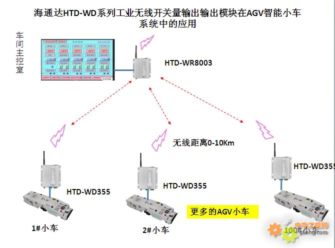

Ò»¡¢²úÆ·¼ò½é£º
        HTD-WD3B0ÊÇÒ»¿î¹¤Òµ¼¶ÎÞÏß16·¿ª¹ØÁ¿ÊäÈë¿ØÖÆÆ÷£¬²ÉÓÃTI×îй¤Òµ¼¶¸ßÐÔÄܵÄMCU£¬±êÅäÎÞÏß¿ÉÊÓ¾àÀë3Km£¨¿É¶¨ÖÆ10-20Km£©£¬ÎÞÏß¹¦ÄܲÉÓÿɿ¿µÄÎÞÏß´«Êä»úÖÆ£¬Òѹ㷺´úÌæÓÐÏߵĿª¹ØÁ¿´«Ê䣬¾ßÓйú¼ÊÁìÏȵĹ¤Òµ¼¶×Ô¶¯»¯²úÆ·Æ·ÖÊ¡£
        HTD-WD3B0ÎÞÏß16·¿ª¹ØÁ¿ÊäÈë¿ØÖÆÆ÷£¬¾ù¿ÉÓëͬϵÁпª¹ØÁ¿ÊäÈëÊä³ö¿ØÖÆÆ÷ÅäÌ×ʹÓã¬È磺 HTD-WD304¡¢HTD-WD308¡¢ HTD-WD30AµÈ²»Í¬Êä³ö·ÊýµÄ¿ØÖÆÆ÷ÅäºÏʹÓ᣿ÉʵÏÖµã¶Ôµã¡¢µã¶Ô¶àµã¡¢¶àµã¶Ôµã¡¢¶àµã¶Ô¶àµãµÄÁé»îÅäÖõĹ¤ÒµÍøÂç¡£
        HTD-WD3B0¹¤ÒµÎÞÏß16·ÊäÈë¿ØÖÆÆ÷Ö§³ÖÊý¾Ý´«Êä³åÍ»¼ì²âCSMA/CA¼°ÎÕÊÖÖØ´«»úÖÆ£¬È·±£ÎÞÏß´«ÊäÊý¾ÝµÄ¿É¿¿ÐÔ¡£
HTD-WD3B0¾ßÓÐͨµÀ¿ìËÙ¼ì²â¹¦ÄÜ£¬ÔÚÄ£¿éÉèÖÃģʽÏ£¬DIÊäÈëͨµÀ´¥·¢Ò»´Î£¬¶ÔÓ¦µÄDOÊä³öͨµÀ״̬¸Ä±äÒ»´Î£¬·½±ãÏÖ³¡¼ì²âÉ豸ÊÇ·ñÕý³£¹¤×÷¡£Ä£¿é²ÎÊýÉèÖ÷½±ã¼òµ¥¡£¾ù¿ÉʹÓÃRFSETÉèÖÃÈí¼þ£¬Í¨¹ýUart ½Ó¿Ú£¬¿ÉÒÔÉèÖù¤×÷Ƶµã¡¢¿ÕÖÐËÙÂÊ¡¢·¢É书ÂÊ¡¢´®¿ÚËÙÂʺ͸ñʽµÈ¡£
