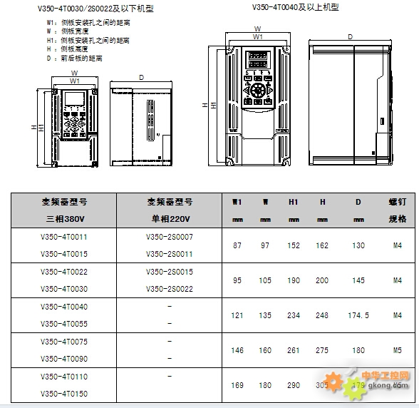

²úÆ·Ðͺţº
-µ¥Ïà220V
V350-2S0007
006M350220007
V350-2S0011
006M350220011
V350-2S0015
006M350220015
V350-2S0022
006M350220022
-ÈýÏà380V
V350-4T0011
006M350430011
V350-4T0015
006M350430015
V350-4T0022
006M350430022
V350-4T0030
006M350430030
V350-4T0040
006M350430040
V350-4T0055
006M350430055
V350-4T0075
006M350430075
V350-4T0090
006M350430090
V350-4T0110
006M350430110
V350-4T0150
006M350430150
°²×°³ß´ç£º
