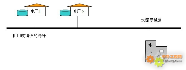

    Ë®³§ÔÚÏß¼à²âϵͳÊÇˮ˾Éú²úµ÷¶È¹ÜÀíϵͳµÄÒ»¸ö×Óϵͳ£¬Ö÷ÒªÓÉˮ˾µ÷¶ÈÖÐÐÄ¡¢Ë®³§¼à¿ØÖÐÐÄ¡¢Í¨ÐÅÆ½Ì¨¡¢Ë®³§²â¿ØÖÕ¶Ë¡¢ÅäµçÉ豸¼à²âÖÕ¶Ë×é³É¡£
---ͨÐÅÆ½Ì¨---
ˮ˾µ÷¶ÈÖÐÐÄ¡¢¸÷Ë®³§¡¢¸÷Ö°Äܲ¿ÃÅÖ®¼äÊý¾ÝͨÐÅÔÚ¾ÖÓòÍøÄÚÍê³É£»Ë®³§Óëµ÷¶ÈÖÐÐÄÖ®¼äÒ»°ã×âÓûòÆÌÉè¹âÏË¡£
