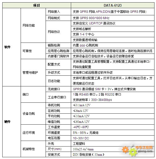

ÐÍ ºÅ£º DATA-6123
GPRSÎÞÏßͨѶģ¿é¾ßÓиßÐÔÄÜ¡¢³¬µÍ¹¦ºÄµÈÌØµã¡£²ÉÓÃÈ«¹¤Òµ¼¶Ð¾Æ¬Éè¼Æ£¬½ø¿ÚGPRSоƬģ×飬ÐÔÄÜÎȶ¨¿É¿¿£»Éè¼Æ½ô´ÕÌå»ýС£¬±ãÓÚÏÖ³¡°²×°ÓëÊ©¹¤¡£GPRSÎÞÏßͨѶģ¿é¹ã·ºÓÃÓÚ¹¤Òµ ×Ô¶¯»¯¡¢Ë®ÎÄË®Àû¡¢»·±£¡¢°²·À¡¢³µÔØ¡¢´«Ã½µÈÁìÓò¡£
Éè±¸ÌØµã
  • µÍ¹¦ºÄ£ºÊµÊ±ÔÚÏ߯½¾ùµçÁ÷≤10mA /12V£¬¿ÉÑ¡ÔñÌ«ÑôÄܹ©µç¡¢µç³Ø¹©µçµÈ£¬ÊÊÓ¦²»Í¬ÏÖ³¡µÄ¹©µç·½Ê½£¬½µµÍ¿Í»§Òò¹©µç´øÀ´µÄ¶îÍâ³É±¾¡£
  • ͨÐŹ¦ÄÜ£ºÖ§³ÖGPRSºÍ¶ÌÏûϢ˫ͨµÀ´«ÊäÊý¾Ý£»Ö§³ÖÓë¶àÖÐÐĽøÐÐÊý¾ÝͨÐÅ£¬Ö§³ÖÓòÃû½âÎö¹¦ÄÜ¡£
  • ÖÇÄÜ»¯£ºÖ§³Ö¶àÖÖ±ê׼ͨѶЭÒ飬Óû§¿É×Ô¶¨Ð­Ò飬֧³Ö͸Ã÷´«Êä¡£
  • Ô¶³Ì¹ÜÀí¹¦ÄÜ£ºÖ§³ÖÔ¶³Ì²ÎÊýÉèÖᢳÌÐòÉý¼¶¡£
