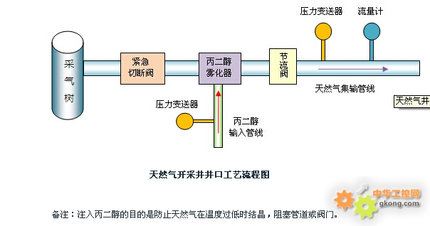

    Îª±£Ö¤°²È«Éú²ú£¬ÌìÈ»Æø¿ª²É¾®¾®¿ÚÆÕ±é°²×°Óнô¼±ÇжϷ§£¬²¢ÅäÌ×½¨ÓР“Æø¾®½ô¼±Çжϰ²È«¿ØÖÆÏµÍ³”¡£
    µ±¾®¿ÚѹÁ¦³¬¹ý¼¯Êä¹ÜÏߵijÐѹ»ò¼¯Êä¹ÜÏ߯ÆÁÑÒýÆðѹÁ¦Ï½µ»òÖÜΧ³öÏÖÏÕÇéʱ£¬¸ÃϵͳÄÜ×Ô¶¯¹Ø±Õ»òÔ¶³Ì¹Ø±Õ¾®¿Ú£¬½Ø¶Ï¾®¿ÚºÍÌìÈ»Æø¹ÜµÀµÄÁ¬½Ó£¬¿ÉÒÔ¼°Ê±ÓÐЧµØ·ÀÖ¹ÌìÈ»Æø´ó¹æÄ£À©É¢£¬½«Ð¹Â©·çÏÕ¿ÉÄÜÔì³ÉµÄËðʧ½µµ½×îµÍ¡£
    Ä³Ê¯ÓÍÐÐÒµÓû§Ó¦ÓÃÎÒ¹«Ë¾µÄÂß¼­¿ØÖÆÆ÷DATA-7301Éè¼ÆÁËÒ»Ì×ÏȽøµÄ“Æø¾®½ô¼±Çжϰ²È«¿ØÖÆÏµ
ͳ”¡£
   ¸Ãϵͳ²ÉÓÃ Æø¶¯Ö´Ðлú¹¹À´ÊµÏÖ½ô¼±ÇжϷ§µÄ¿ª¡¢¹Ø¿ØÖÆ£¬´ó´óÌá¸ßÁ˰²È«½Ø¶ÏÏìÓ¦ËÙ¶È ¡£Æø¶¯Ö´Ðлú¹¹µÄÆøÔ´À´×Ô´óÆøÖÐµÄ¿ÕÆø£¨¿Ë·þÁËÀûÓõªÆø×ö¶¯Á¦Ô´£¬¿ª¡¢¹Ø·§ºóÐèÈ˹¤µ½ÏÖ³¡¸ü»»µªÆøµÄȱÏÝ£©£¬¶¯Á¦Ô´Ê¼ÖÕ±£³ÖÔÚ0.5~0.7MPa¡£µ±½ô¼±ÇжϷ§Ö´Ðпª¡¢¹Ø¶¯×÷£¬¶¯Á¦Ô´Ñ¹Á¦Ï½µºó£¬¿ØÖÆÏµÍ³×Ô¶¯Í¨¹ýÆø±ÃÏò´¢ÄÜÆ÷Öв¹³äÆøÔ´¡£
     Âß¼­¿ØÖÆÆ÷DATA-7301×÷Ϊ¸ÃϵͳÖеĺËÐÄ¿ØÖÆÉ豸£¬Ö÷Òª×÷ÓÃÈçÏ£º
£¨1£©¼ì²â½ô¼±ÇжϷ§µÄµÄ¿ªµ½Î»¡¢¹Øµ½Î»×´Ì¬¡£
£¨2£©¼ì²âÌìÈ»Æø¼¯Êä¹ÜÏßÉϵÄʵʱѹÁ¦Öµ£¬³¬Ñ¹»òǷѹʱ£¬×Ô¶¯¹Ø±Õ½ô¼±ÇжϷ§¡£
£¨3£©¼ì²â¶¯Á¦Ô´´¢ÄÜÆ÷µÄѹÁ¦ÏÂÏÞºÍѹÁ¦ÉÏÏÞ״̬¡£´¢ÄÜÆ÷ѹÁ¦µ½´ïÏÂÏÞʱ£¬×Ô¶¯Æô¶¯Æø±ÃÏò´¢ÄÜÆ÷
Öв¹³äÆøÔ´£»Ñ¹Á¦µ½´ïÉÏÏÞʱ£¬×Ô¶¯¹ØÍ£Æø±Ã£¬È·±£´¢ÄÜÆ÷ѹÁ¦±£³ÖÔÚ0.5~0.7MPa·¶Î§ÄÚ¡£
£¨4£©²É¼¯ÆäËüѹÁ¦¡¢Î¶ȡ¢Á÷Á¿µÈÒDZíÊý¾Ý¡£
£¨5£©Í¨¹ýÊý´«µç̨ÓëÉú²ú¿ØÖÆÖÐÐĽøÐÐÔ¶³ÌͨÐÅ£¬½«ÏÖ³¡É豸ÔËÐÐ״̬ºÍ¸÷ÀàÒDZíÊý¾Ýʵʱ·¢Ë͸øÉú
²ú¿ØÖÆÖÐÐÄ£»Í¬Ê±½ÓÊÜÉú²ú¿ØÖÆÖÐÐĵÄÃüÁִÐÐÔ¶³Ì¿ª·§¡¢¹Ø·§²Ù×÷¡£
