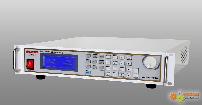

²úÆ·Ãû³Æ£º ¿É±à³Ì¿ª¹ØÖ±Á÷µçÔ´KRSP-3000-30010
ÐÍ ºÅ£º KRSP-3000-30010 300V/10A
KRSP-3000ϵÁпɱà³ÌÖ±Á÷¿ª¹ØµçÔ´
²úÆ·ÌØµã
¡ñµçѹ5V~300V¡¢µçÁ÷1A~400A ³¬¹ý 30¸ö»úÖֿɹ©Ñ¡Ôñ¡£
¡ñÍâÐÍÇáÇÉ£¬ 2U´ï3500W£¬µ¥»úʹÓûòÉÏÒÇÆ÷¼Ü¶¼ÊÊÓá£
¡ñ¶¨µçѹ£¨CV£©/¶¨µçÁ÷£¨CC£©×Ô¶¯Çл»£¬·´Ó¦¿ìËÙ¡£
¡ñÈ«ÊýλÉè¼Æ£¬¸ß½âÎö¶È16Bit DAÉ趨Êä³öµçѹ¡¢µçÁ÷£¬¸ß½âÎö¶È24Bit AD ¶Á»Ø£¨²âÁ¿£©Êä³öµçѹ¡¢µçÁ÷¼°¹¦ÂʲâÁ¿ÏÔʾ¹¦ÄÜ
¡ñ¿É²¢Áª¶ą̀µçÔ´¹¤×÷
¡ñ¾ß±¸¸ßЧÂÊÖ÷¶¯¹¦Òò£¨APFC£©¡£
¡ñ¿É³Ìʽ¹ýµçѹ¡¢¹ýµçÁ÷±£»¤£¬¹¦Âʰ뵼Ìå¹ýÈȱ£»¤£¬·´Ïò¡¢ÄæÏò±£»¤£¬»ØÊÚÀ‰µôÂä±£»¤¡£
¡ñÌṩÊä³öµçѹ»ºÉý£¨Ramp up£©£¬²¢¿ÉÉ趨»ºÉýʱ¼ä¡£µçѹ»º½µ£¨Ramp down£©£¬²¢¿ÉÉ趨»º½µÊ±¼ä¡£
¡ñOne Key Recall£¬100×é¼ÇÒä
¡ñ¹Ø»úǰ¼ÇÒ䣬KeyLock ¹¦ÄÜ¡£
¡ñÔ¶¶ËÊýλÁ¿²â»ØÊÚ²¹³¥µçѹ×î¸ß5V.
¡ñRS-232CΪ±ê×¼½éÃæ£¬Ñ¡¹ºGPIB¡¢CAN¡¢LAN½éÃæ¡£
¡ñÖ±Á÷Êä³ö ON/OFF ¿ª¹Ø¡£
Ö÷ÒªÖ¸±êÈçÏ£º
ÔÚ³£ÎÂ0-40¡æ£¬Êª¶È80%¹¤×÷Çé¿öÏ£º
1¡¢ µçѹ±à³Ì¾«¶È£º 0.05% + 0.02% of F.S
2¡¢ µçÁ÷±à³Ì¾«¶È£º 0.1% + 0.1% of F.S
3¡¢ µçѹ»Ø¶Á¾«¶È£º 0.05% + 0.02% of F.S
4¡¢ µçÁ÷»Ø¶Á¾«¶È£º 0.1% + 0.1% of F.S
5¡¢ ÎÆ²¨¼°ÔëÉù£¨from 20Hz to 20MHz£©£º≤ 150mV p-p
6¡¢ ¸ºÔص÷ÕûÂÊ µçѹ ≤ 0.06% µçÁ÷ ≤ 0.15%
7¡¢ µçÔ´µ÷ÕûÂÊ µçѹ ≤ 0.02% µçÁ÷ ≤ 0.03%
8¡¢ ²ÉÓôóÐÍLCD ÆÁ192 X 64ÏÔʾ
Kingrang Ä¿Ç°ÍÆ³öKRSPϵÁÐÐͺŹæ¸ñÈçÏ£º
KRSP-3000-0560 5V/60A
KRSP-3000-0575 5V/75A
KRSP-3000-05100 5V/100A
KRSP-3000-05120-5V/120A
KRSP-3000-05150 5V/150A
KRSP-3000-05200 5V/200A
KRSP-3000-1060 10V/60A
KRSP-3000-1075 10V/75A
KRSP-3000-10100 10V/100A
KRSP-3000-10120-10V/120A
KRSP-3000-10150 10V/150A
KRSP-3000-10200 10V/200A
KRSP-3000-3050 30V/50A
KRSP-3000-3060 30V/60A
KRSP-3000-30100 30V/100A
KRSP-3000-35100-35V/100A
KRSP-3000-5020 50V/20A
KRSP-3000-5030 50V/30A
KRSP-3000-5050 50V/50A
KRSP-3000-5060-50V/60A
KRSP-3000-10010 100V/10A
KRSP-3000-10020 100V/20A
KRSP-3000-10030 100V/30A
KRSP-3000-15010-150V/10A
KRSP-3000-15020-150V/20A
KRSP-3000-20005-200V/5A
KRSP-3000-20010-200V/10A
KRSP-3000-20015-200V/15A
KRSP-3000-30003-300V/3A
KRSP-3000-30005-300V/5A
KRSP-3000-30010-300V/10A
