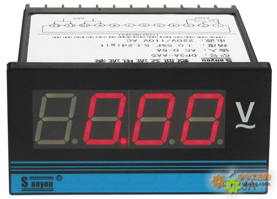

²úÆ·Ãû³Æ£º ÊýÏÔµçѹ±í
ÐÍ ºÅ£º DP3A-AV600
DP3AÈýλ°ëÊýÏÔµçѹ±í¡¢µçÁ÷±í
1.ÌØµã
·0.8´çºìÉ«´óÊýÂë¹ÜÏÔʾ£¬ÇåÎúÖ±¹Û
·²ÉÑùËÙ¶È2.5´Î/Ãë
·ÍâÐͳߴç48H×96mm£¬ÏÔʾ·¶Î§±1999
2.ÐͺÅ˵Ã÷
ÊäÈëÐźŠAA:½»Á÷µçÁ÷£»AV:½»Á÷µçѹ£»DA:Ö±Á÷µçÁ÷£»DV:Ö±Á÷µçѹ£»
µçÁ÷Êä³ö£ºÈ±Ê¡ÎÞ£¬I:4-20mAÊä³ö
µçÔ´£ºÈ±Ê¡220VAC,E:12-30VAC/DC
ȱʡ³ß´ç£º48H×96×100ÁË5£º48H×96W×80L
3λ°ëÊý×Ö±í
*Ñ¡ÐÍʾÀý£º²âÁ¿½»Á÷µçÁ÷±í£¬Á¿³Ì200AÅä200£º5A»¥¸ÐÆ÷£¬Ñ¡ÐÍΪDP3-AA200.

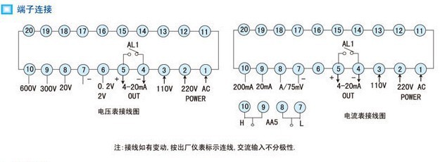

7.¶Ë×Ó°²×°
×¢£º½ÓÏßÈçÓб䶯£¬ÒÔ³ö³§ÒDZí½ÓÏßΪ׼ȷ.
